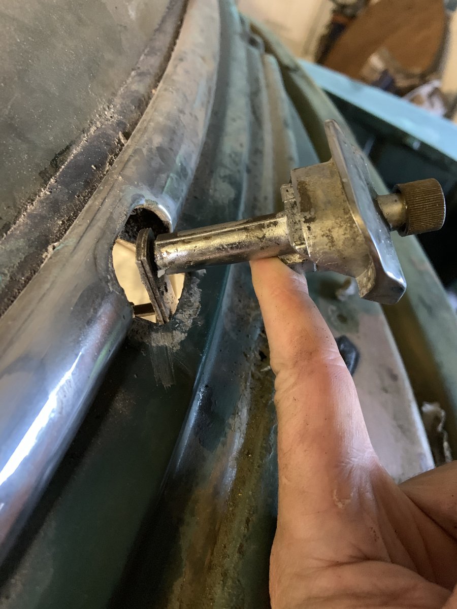

    Hey. This might be a simple question but I don't know how to do it.
    I have a 51 Styleline. I took off the wiper arms but I can't figure out how to get the s/s wiper cover off. But what is the trick to getting the little chrome wiper arm cover off? Seems like the pinion tip that holds the arm needs to come off to remove the cover. Does it screw off? Pry off? IMG_3575.jpg (I know I can unscrew the bolt underneath the dash but it doesn’t seem to give room to remove that cover.)
    Any advice?

    it's not just a cover, it's an ***embly....try unbolting it from below.

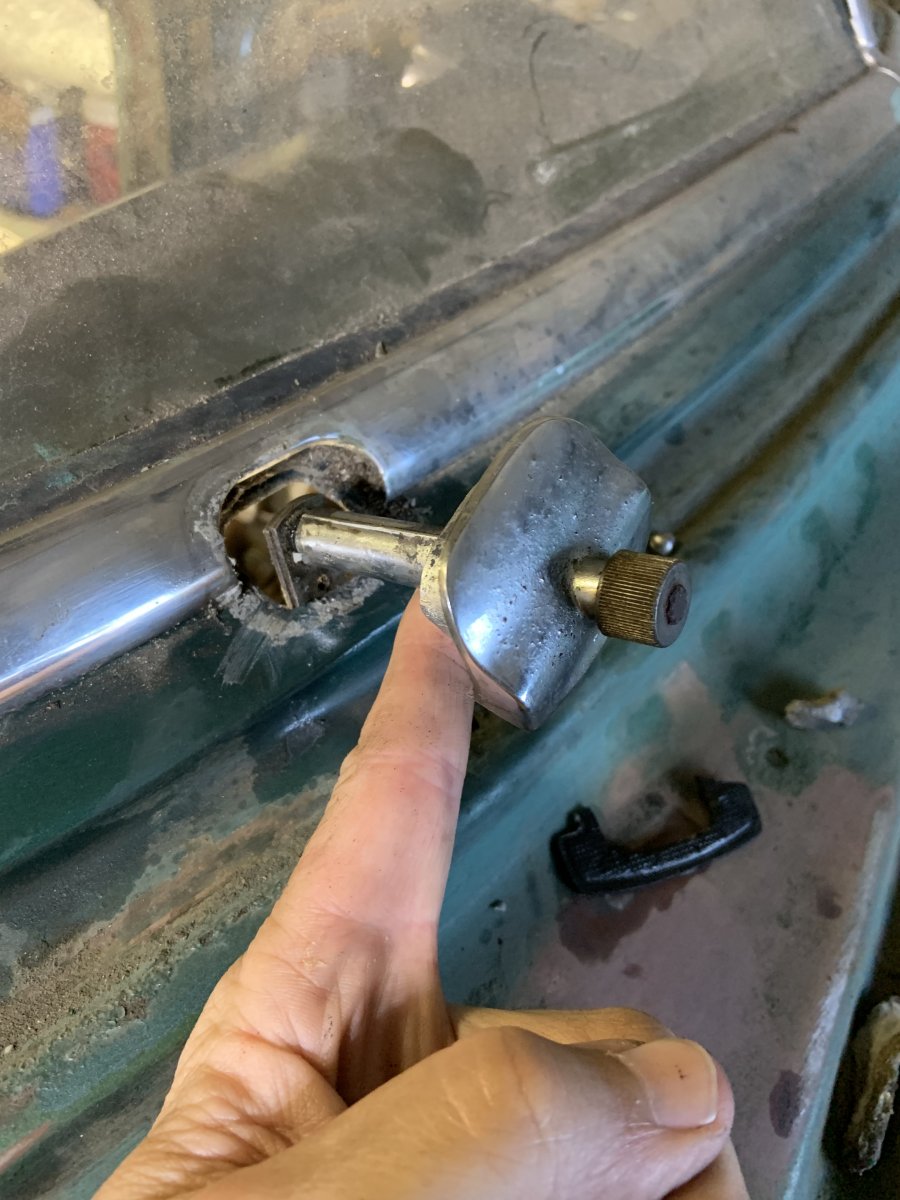

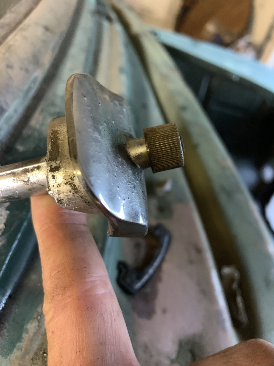

    Thanks. But I’m still having trouble getting it off. I unscrewed the underside bolt and part i want is loose. But I cant detach the outside unit from the wiper arms underneath. The arms are riveted. Does the shaft slide off somehow from the transmission arm? Or does the pinion tip pop off? I want to rechrome the wiper cover unit. Seems like it should be easy to get off but like everything’s else with this car... nooooo. A7554B59-8662-4EE0-A655-2845096E2BFC.jpeg 2415BCA2-45EA-4E41-8566-B77FD73B9038.jpeg 46482132-7C8C-4096-AFBC-66EF9DDE9E0F.jpeg BB437605-719C-4C87-BBEE-DC01A27D32EA.jpeg

    disconnect the other end of the long link from the wiper motor.
    Lift the ***embly out of the car.

    You'll need to disconnect the arm from the motor and pull the whole ***embly out.
    squirrel is quick!

    Aha. I see. I guess I was so focused on just removing that end cap to rechrome that I was blind.
    But now I see.
    I still wish it was removable to rechrome. Might just paint it with chrome paint (?). Or maybe I’ll just clean it up.
    Thanks for your fast ***istance.

    I would just clean it with steel wool or something, and not worry about it. But I'm lazy like that.
    if you want to take it apart, you'll have to figure out how to put it back together. It is swedged or something, that little splined end that the wiper arm fits onto. If you can find another pair, you could experiment with one pair and see if you can get them replated and back together. Usually, things like that don't work out very well, in my decades of experience doing this stuff.

    Will the splines on the outside come off, some are pinned. Replacement splines are pinned or set screwed
