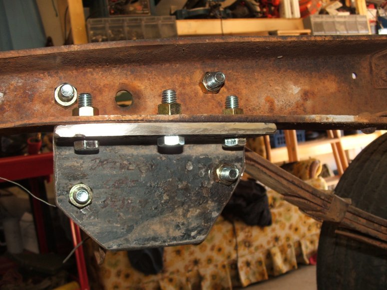

    The reason I'm boxing the rear section (from the rear-most crossmember back is because of how I have my parallel leaf sprung 9" rear end mounted. I also intend to eventually install a trailer hitch to pull a small camper with for the wife and I to byp*** the hotels.
    Check out the picture and you'll be able to see what I'm talking about. I know they are heavy, but to me, this is the weakest part, as it narrows down to only 2" in this area. I'm actually tying the rear frame rails together, as well as boxing the side rails to the closest crossmember. It'd probably be okay, but with Mr. Murphy and his laws following me around, I'd rather err on the side of too much than not enough.
