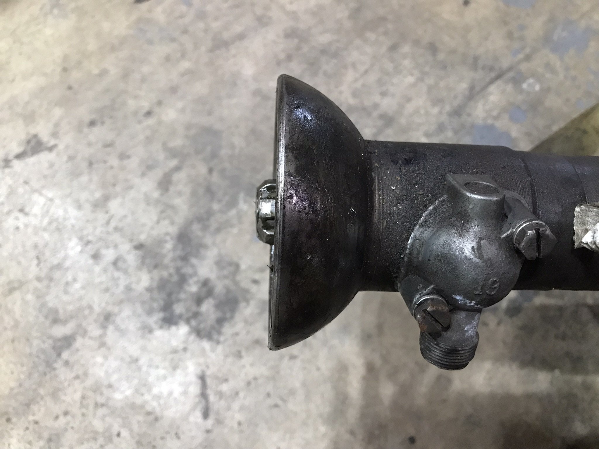

    In the process of building a low buck AV8. Cobbled together 3 roached V8 banjo rears to make one. In the process mixed up all the parts. Shortened the tube to fit and had the shaft I thought was its mate shortened the same amount I took out of the tube. In the photo I have 1/4' of shaft sticking out past the torque tube bell. Is this in the ballpark??

    Over the years of working with banjo rear axle assemblies I have seen the drive shaft flush with torque tube bell end, 1/8 " deep and 1/8" proud. You'll probably be okay.

    I've done several, usually the chamfered end of the splines is about an 1/8", and thats what sticks out when you lay a straight edge across the bell. Same thing if you look at a stock shaft & tube.

    What you have sticking out now looks pretty much right from memory . Oh wait I can check my 32 PU it has no engine or trans at present. Awaiting a leaking trans rebuild and a mystery heart murmur in the cragar head B4.
