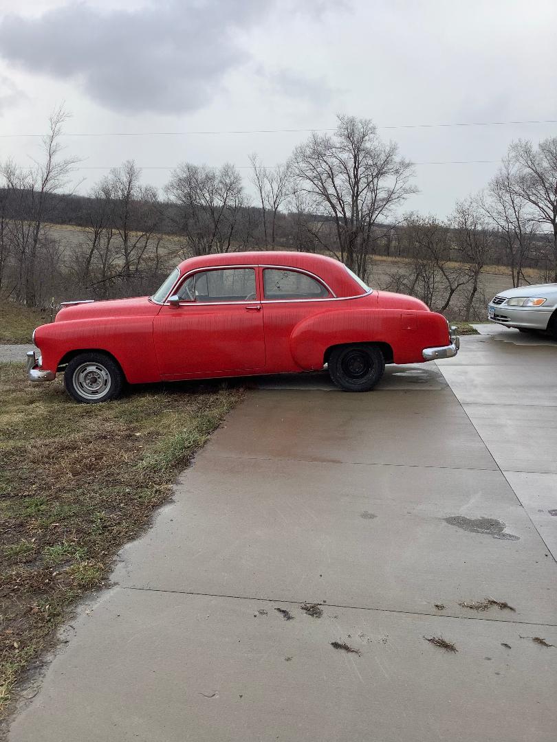

    Any pics of this build? 800 horse in a stock appearing 51 Chevy is insane to me.
    Bandit Billy and 5window like this.
  21. snoc653
    Joined: Dec 25, 2023
    Posts: 982
    snoc653
    from Iowa
    The pile of parts is in the shop, I'm making room for the car still so I can get the stock drivetrain out and the newer stuff in. As it sits now it looks stock, because it is. The front end will come down just a little. Other than that, I like the stance and want to keep the stance. Wheels undecided at this point. I need to get the rear end in and see what will fit with what back spacing. Leaf springs and traction bars on the rear is the current plan. This year make it a driver and get comfortable with it. Next winter do the body work and make it pretty. upload_2024-2-5_22-24-38.jpeg

    Are those bullet holes :eek:

    Yes. They go through both back windows. Which reminds me, I need to order new back glass. They were that way when I bought it. It does add character and says the car is a fighter. LOL
