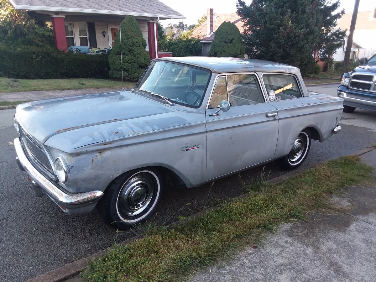

  6. Some AMC had a torque tube rear end which makes it harder to change transmissions.If you found a donor car with a auto in it you could take everything you needed.
  7. sevenhills1952
    Joined: Mar 14, 2018
    Posts: 956
    sevenhills1952
    I've always liked Americans and have 1958 (first) through 1969 (last).
    Ad goofed some, it's a 196 (195.6) ci.in. flathead. 3 on tree. The Super you could have had an automatic, I prefer manual.
    Last picture shows some floorpan rot.
    Swapping to automatic wouldn't be too difficult IF you happened to have a donor car with a good transmission and all ***ociated parts. Otherwise (my opinion) it wouldn't be worth it.
    Me... I would buy it only if driver(s) can drive a straight. It's extremely easy once you get used to it.
    Sent from my Bell Candlestick
  8. nickleone
    Joined: Jun 14, 2007
    Posts: 478
    nickleone
    I took a good look at pictures there is a big rust hole in the floor.
    Ramblers did not have a frame son no frame off restro they are uni body.
    No torque tube on this early model.
    Run away.
