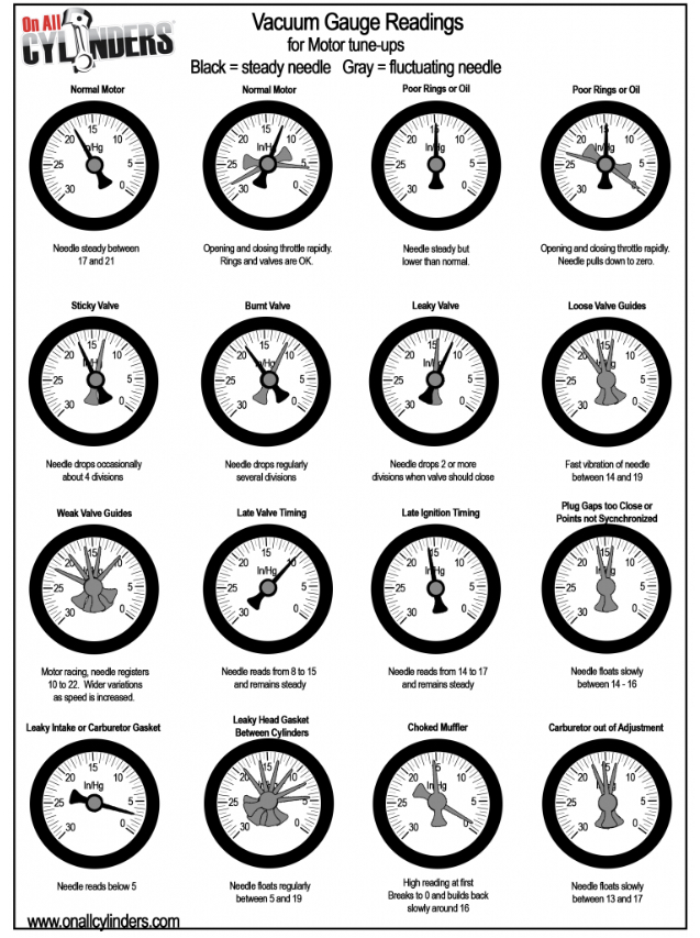

  14. Sharpone
    Joined: Jul 25, 2022
    Posts: 3,544
    Sharpone
    IMG_2418.jpeg Along with a compression test, check vacuum
    Compression - Now What?
    Result Likely Culprit
    Pressure starts low and stays low
    Adding 1tbsp of oil does not increase pressure Valves
    Pressure builds up, but not high enough
    Adding 1tbsp of oil increases pressure Piston Rings
    More than one adjacent cylinder show low pressure Headgasket
    All pistons show low pressure (<100 psi)
    Adding 1tbsp of oil does not increase pressure Timing
    No Pressure Piston, Other Engine Damage
    High Pressure Carbon Buildup
    alanp561 and snoc653 like this.

  16. Sharpone
    Posts: 3,544
    Sharpone
    A compression and vacuum test will verify ring, and valve health, valves that need adjustment won’t show up unless severely out of adjustment
