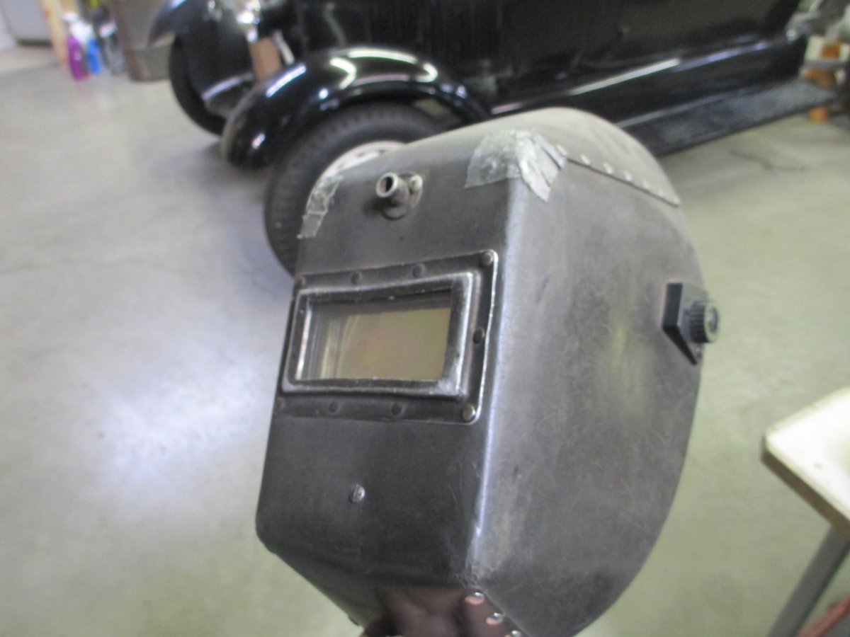

    All this talk about auto-darkening helmets, so I thought this might be of interest. Huntsman in the late 60's built what they called an auto-view hood. I bought this one in 1969 for $16.50, when I was a production welder at Freightliner Corp. doing mig and tig on aluminum parts. With the lever pad under your chin, you simply opened and closed your mouth to slide the dark lens up and down. If you didn't keep it clean and lightly lubricated, it would stick open from time to time. That prompted law suits, so they stopped manufacture in the 70's. It has been a handy tool over the last 50 years, for me. IMG_4595.JPG IMG_4597.JPG

    I have one of those, only use it in extreme cir***stances, where you head is crammed into a tight space, I think they called it a welding sock.

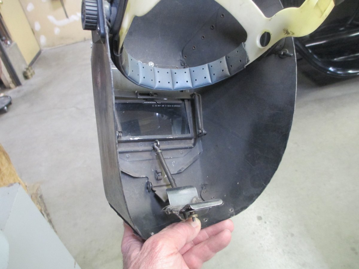

    Accu-Strike makes a helmet similar to this. That's what I've been using for almost 10 years.

  23. Been welding for 40+ years and never seen one of these, if someone had described it to me I would of called ********.
