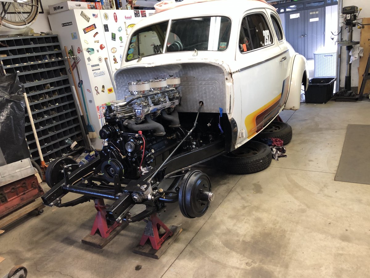

    • I did this back in 1975. Never had any problems with it and ran a top speed at Bonneville of 149 and El Mirage of 152. I had more fear of a flat tire at speed than any other concern. Putting the axle on top of the springs just seemed like the easiest way to lower the car. 6E1B87E1-2E24-44A8-88D7-9515ED86B56E.jpeg
