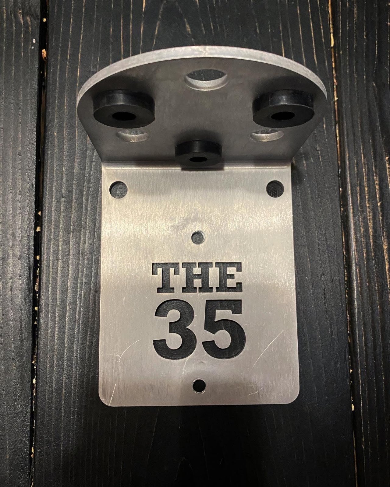

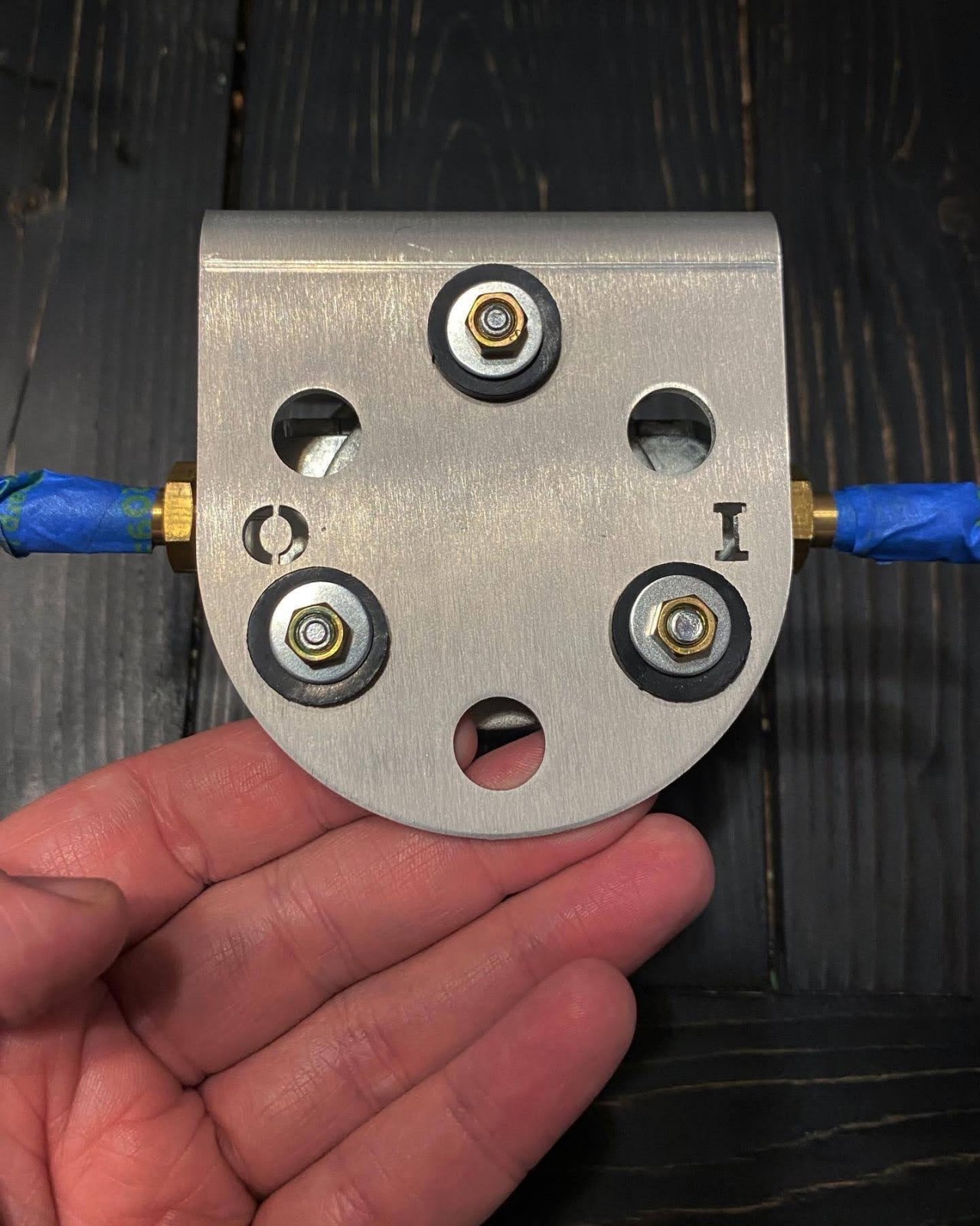

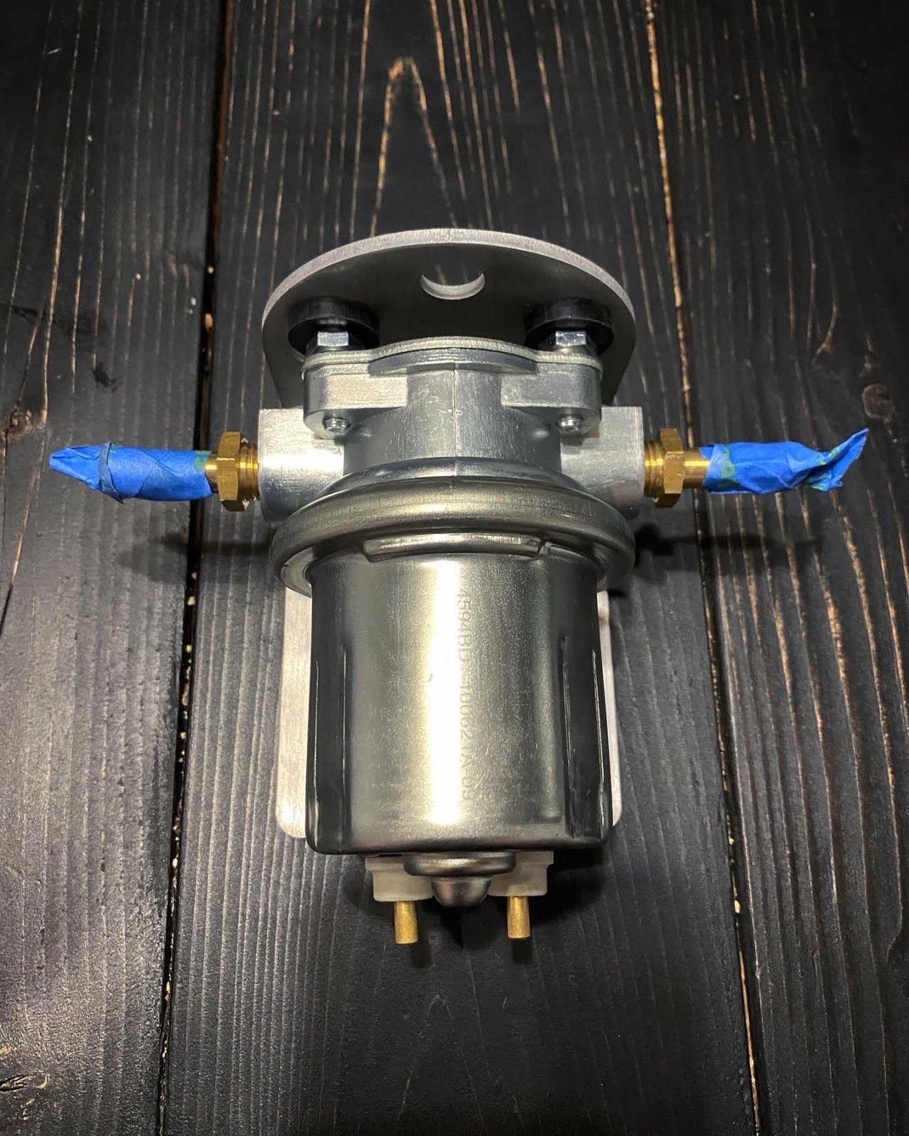

    The Plan:
    The first thing I did was buy a nicer pump. Went with the Carter P4594 pump. And then decided to remake the mount so I could mount two electric fuel pumps off of one mount. That way if I lost the Carter pump I could switch over to the Edelbrock that has gotten me home twice now.

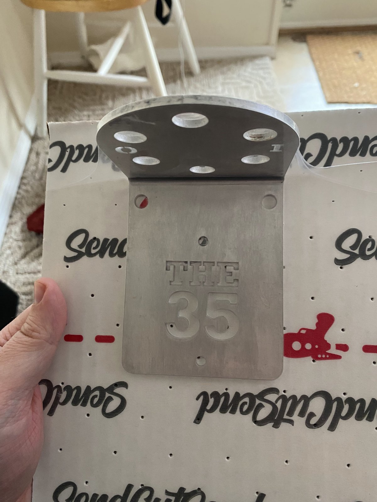

    My original intent was just to make this out of sheet metal but then I stumbled upon SendCutSend.com. You can upload a design to their site and they will laser cut it out of whatever material you spec out.
    So I made the design in illustrator (I’m an art director for an ad agency for my day job) and sent them my file. A few days later I got my mount in the mail. To my surprise my ability to read a pair of calipers proved to be dead on the money. Now if I lose an electric pump I simply switch hoses to the back up pump and unplug one weather proof connect and plug it into the other one.
    But I hope I don’t have to. See pictures below for a better representation of what I did. After doing this and my 3D printed waterfall I’ve discovered that I really like making these one off parts that have a real world purpose. I have started another MUCH more ambitious project and hope to be posting about it soon.

    Pretty nice work from SendCutSend.com. Not just cutting the shape but doing the bend too.
    I didn't know laser cutting could limit the depth of cut - on the "THE 35" text.

    I thought they did an excellent job. The "THE 35" is cut all the way through the material.
