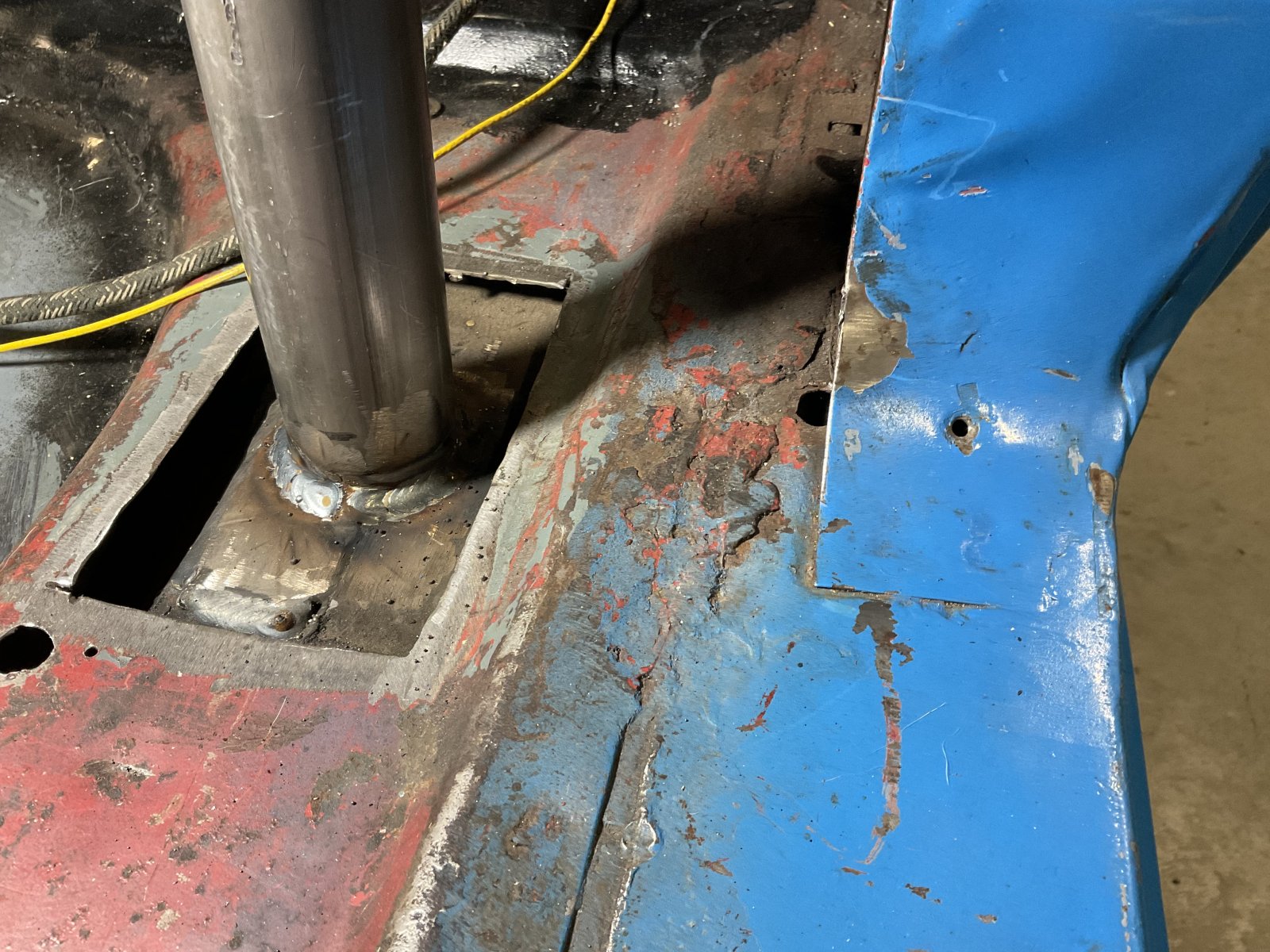

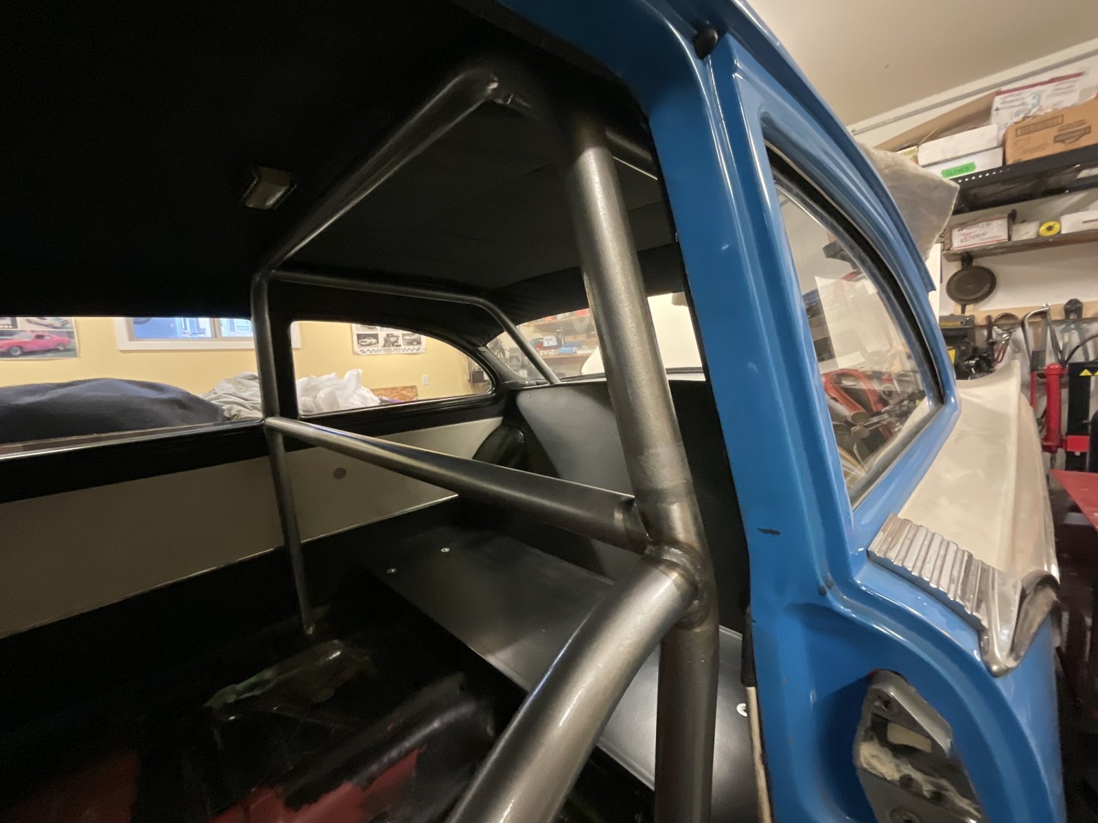

    You could do a 5 or 6 point roll bar, and upgrade to a full cage later, if you so desire. As others have stated, if you can retain the stock floor and firewall, it will be good for 10.00. Here is a 55 I did sometime ago, outriggers on the frame. IMG_3064.JPG IMG_3066.JPG

    Had a long talk tonight with Mr. Carzoli. He helped me clear up my mental picture of how to put it together. My plan was good and now it’s better. Basically the cage will be welded to plates and bolted to the floor. There will be connecting braces welded to the plates under them and running to the frame. They will be welded to the frame. Standard 8.50 cage engine low in the mounts, x-frame cross member for trans mount with front driveshaft loop attached. I told him there was a local guy that I was going to talk to and asked if he would recommend anyone in my area to help with the cage and ch***is. He said my guy’s name. That made me feel a lot better about the plan adjustments I’ve been leaning toward. Still not going to dial in under 10.0 any time soon. He said go ahead with the 700r4, no transmission lives forever and some will surprise you. The guy he recommended was the guy that built the trans and he apparently knows his stuff. He liked the mini tubs and tires in the 10.5 to 12 inch wide range as a little slip can be more forgiving And something that came up in conversation was he mentioned someone had a notebook with all their SFI cert info. I liked that and mentioned that I was going to steal that ideal. From seatbelts to flex plates not all stickers are easy to see. Should help to make sure I’m on top of it.

    Hmmm...when I read the rules, this isn't allowed. The cage needs to be welded to the frame.

    The NHRA states – All cars with an OEM frame must have roll bar attached to frame. Cars without frame use 6″ square 1/8″ steel plates on top and bottom of floor, securely bolted together with at least four 3/8″ bolts, or top plate welded to rocker sill. Maximum of 6″ from roll bar to driver's helmet. Attached to the frame, I believe, does not imply it has to be welded to the frame. Then again, I've been wrong before.
    RmK57 and squirrel like this.

    Correct, a bolt in bar or cage will only get you to 11 flat.

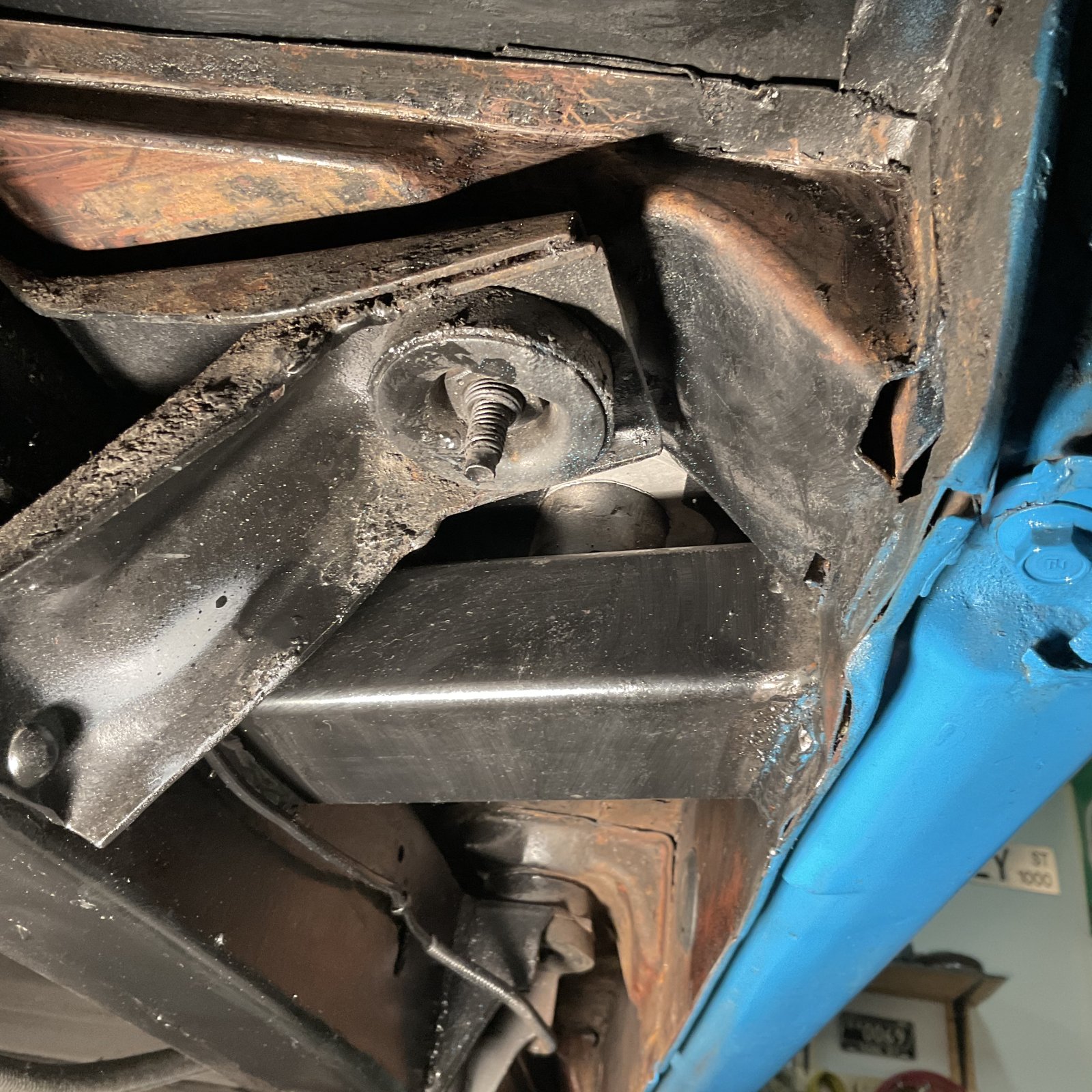

    Because of the way the frame curves in by the front of the door I had to weld in outriggers from the inside rocker to the outside of the stock frame, then weld the door bar on top of the outrigger. It’s legal to 10.00. Makes it more work to keep it legal but better than getting told to redo your plates bolted to the floor. IMG_0490.jpeg IMG_0520.jpeg IMG_0517.jpeg

    Our cars have frames that are nowhere near wide enough to weld the cage directly to the frame. Thus, the cage can't be welded to the frame. If the cage was welded to the frame, half of the driver would be outside of the cage on our cars. They don't expect you to put a new frame under the car. The rule you are describing was designed for Off Topic cars with the frame rails out near the rocker panels and possibly some of the corvettes.
    This is exactly what he said. The plates sandwich the floor. The cage could be welded directly to the outrigger and floor or can be welded to the plate, plate underneath and the under side plate welded to the outrigger from the frame. The plates can be bolted or welded down. Per the rules, if the plate is welded to to floors, the weld must cover every bit of edge and be a proper weld. If it is bolted it takes 4 bolts. One in each corner. Bolted makes it easier to take the body off the car if you ever need to. So that is the plan.

    If the guy who certifies cages to run 9s says he'll cert it that way, then I guess it'll work, eh?
    On my 55 I bent the main hoop in near the bottom to weld it to the frame, and ran an outrigger on the driver side to attach the door bar.
    The way I read the rules, plates at the floor are something for unibody cars, not frame cars. I used plates, fully welded, to attach the cage on my Chevy II.
