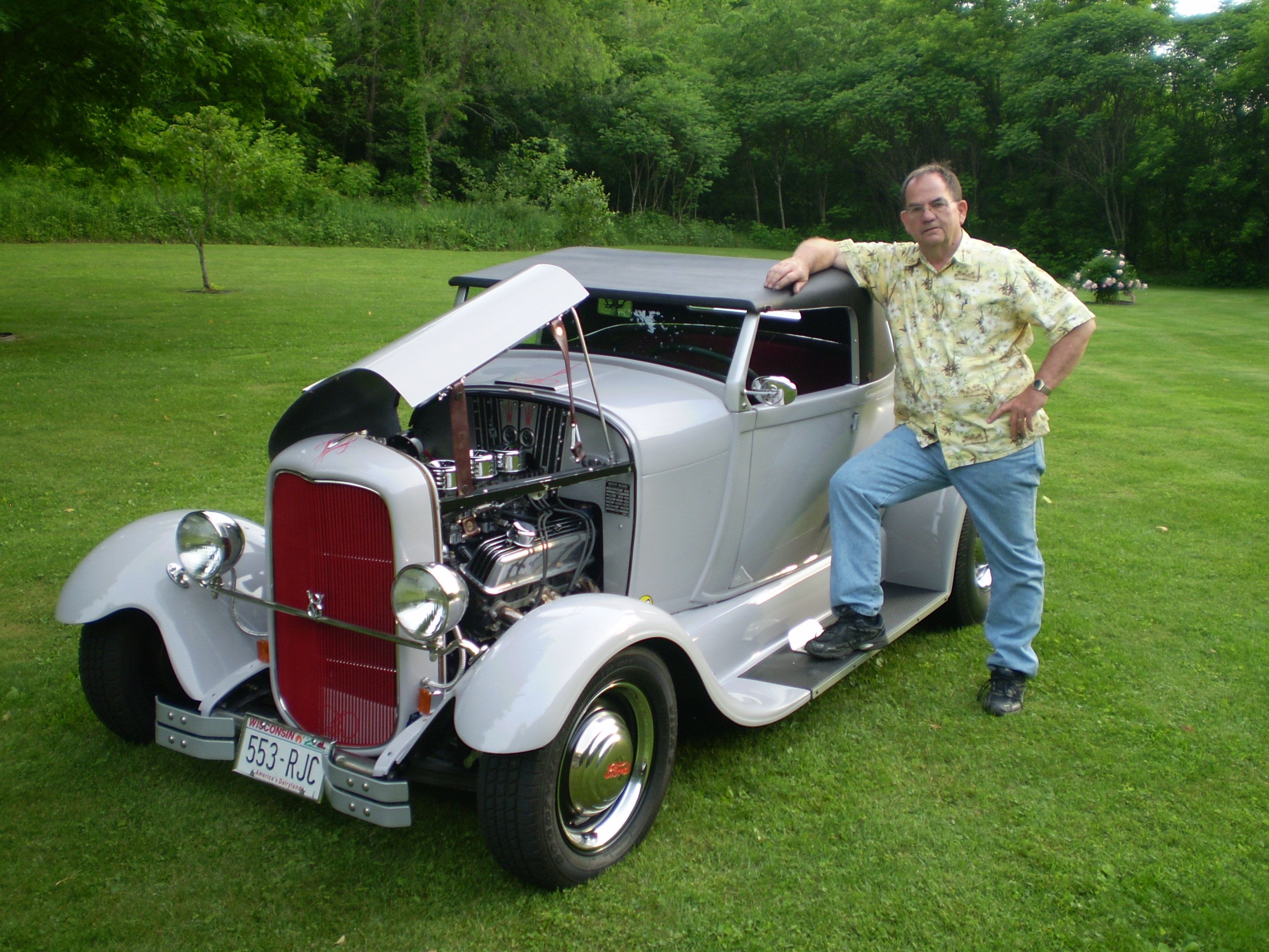

  9. 4 inch dropped axle, reverse eye spring in front. Rear is uncut JW Rod Garage frame with 8 & 3/4 Mopar rear. I think it's about as low as you can get one without cutting the frame. I'm 5' 10 " and the roof is armpit high!!!
    05snopro440 and Max Gearhead like this.
  10. Is this low enough for ya????
  11. F-6Garagerat
    Joined: Apr 12, 2008
    Posts: 2,652
    F-6Garagerat
    That's a 28-29 on a 32 frame. Not model A.
