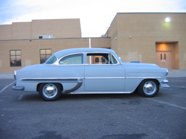

    Get a weight belt for your kidney's. Just kidding, you should be fine with the 4" you were planning. If that is the height that you like it at then leave it. I have driven numerous vehicles with hardly any suspension travel and my Wife was there for the ride also. It's a bit ruff in the beginning but you get use to it. Low and slow is the name of the game right? Well maybe not with that Rajo conversion but you get the idea. I would leave it with the 4" blocks and cut half of that snub off. And if you can throw a small c-notch in the rear. It will make a world of difference. Love the car and your work ethic.

    My 54 has 3 inch blocks and it was riding on the snubbers.
    I knocked them out and then it hit the frame on big bumps.
    I ended up putting air shocks on with about 30 to 40 lbs of air
    in them and it does pretty good and didn't really raise it up.
    Looks great....good luck!

    Wow! Car looks tons better. You will probably be better off with 3 inch blocks for the ride quality. I had no Idea there were women who actualy liked cars, let alone had good taste and did their own work. WILL YOU MARRY ME?

    here's how I do it.
    yep it'll hit...but you can control it.
    the progressive rate snubbers are pretty cool, but have a fatal flaw- longevity.
    I have been using Timbren S.E.S. "springs" for a while now. they aren't springs at all, they are effectively large rubber donuts that taper in top and bottom. They are hollow with a bolt hole in one end.
    what I have done is pretty simple. they are about 3 inches in total height. you don't wanna go riding around on them, because they progressively increase the spring rate-meaning they make the car bouncy as hell. so to combat this issue, I make a bracket out of some 2x2 tubing- simple as it gets- take a 3 inch long section of it, and cut it diagonally across, effectively making 2 -3 inch wedges.
    drill 3/8 hole 1 inch from the "outside" (pointy end)
    bolt the "spring" to it.
    position it so the "wedge" sits just on the lip of the frame, then move it "up" 1 inch from there over the axle.
    weld that ****er on there.
    what you have done is simple. re-positioning the bump stop, and replacing the rubber one with a helper spring. the overall effect is pretty *****in. in the event you jump it across some railroad tracks, you will bottom out. however, in the event you simply find the bottom of a deep pothole, it doesn't. it you load the trunk with beer and beef, it will ride on the stops, but the ride isn't obnoxious at all.
    all in all, it's about 1000 times easier than it sounds. any gal who can mount and balance her own tires should be able to pull this off in spades!

    Just a thought here,you need to ditch those shackles and get some stock ones. the bolt through the steel plate idea is terrible .You will have handling problems because the bolts will allow the shackle to bend. The car will feel like it's doing a **** wiggle comming out of turns.
    I'm not a fan of lowering blocks myself.If it's looks you want..fine,but if it's a better ride and handling go for bags. Because i drive my cars constantly i need ride above looks so practical considerations come first.
    And those upper bushes are shot....best replace those too.
    have you considered shock travel? lowering it is going to make the shock absorbers too long.you can always use those airshocks to adjust the ride height /versus comfort to get it right .

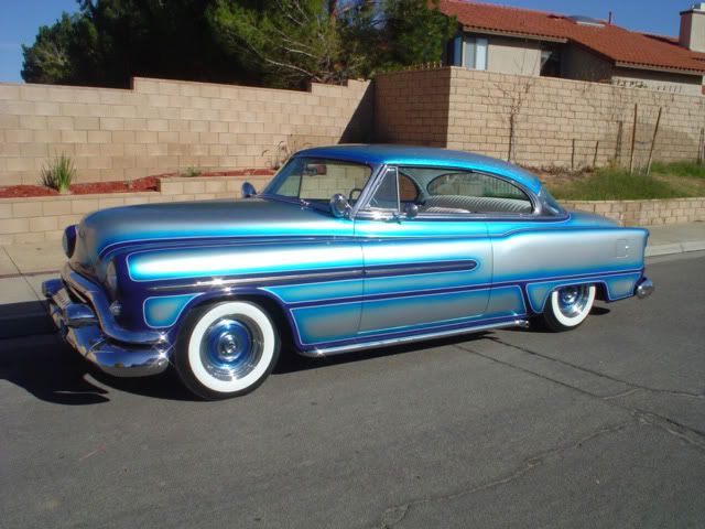

    Posts: 920
    Eryk
    Looks good Megan.
    My 53 Olds is lowered the the same amount as your Chevy. My leafs have almost no arch left. My pumpkin hits really nasty on hard bumps, or in freeway situations where there are big dips. I try to avoid them at all cost, but sometimes **** just happens. It ain't fun. It feels like someone is smashing your rearend with a sledge.:( My car isn't even that low. I fell like if I'm gonna take kidney shots every time I drive, my car should at least look crazy low...and it doesn't.:rolleyes:
    I'm cutting the trunk for clearance till I can re-do the whole rear suspension. Notch, tunnel, bags, etc.
    Good luck. Looks like you're making great progress already.
