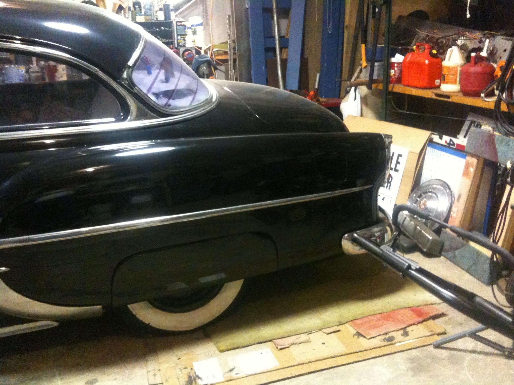

    I'm talking for safety reasons. I'm running 4 inch blocks on what I think are the stock springs. Without a notched frame, I'm hitting the rubber bump stops in the fenderwells with the rearend. I've been thinking about bagging it or changing out the rear springs. Should I be worried about how it sits now? Thanks, guys!

  10. THE_DUDE
    Joined: Aug 22, 2009
    Posts: 2,601
    THE_DUDE
    Looks low enough to me. Lets see a side shot of the whole car.

  17. hotrod54chevy
    Joined: Nov 7, 2003
    Posts: 1,590
    hotrod54chevy
    from Ohio
    A virtual 360 around my car! :D
