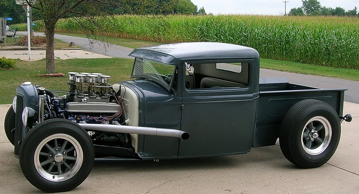

    Well, after a long time coming , and quite a few $, I'm back to working on my 39 Plymouth pick up. I had a "pro" build the frame, ***emble front end, steering, rear 4 link, mount engine and trans, cab, etc. So it's a "roller" I did tell him I wanted it fairly low, but... It's about 4" from the floor to the lowest part of the engine which is the adapter on the Desoto hemi to 727 trans.
    I'm concerned about dragging everywhere I go, my driveway turn being one place ! Raising the engine/trans mounts looks to be do-able with some fab involved. What's some opinions here ? No bags for me !

    Personally,I think you might need to raise the engine a little,at least keep the oil pan above the scrub line,as far a sheet metal 4" is not too low IMPO. HRP

    pictures! It kind of depends on how far behind the front wheels, that low point is. We can't tell from your description.
    but yeah, that's kind of low, and if you don't have all the weight on the car yet, and the ride height is not adjustable, you'll probably be in trouble by the time it's finished

    I would want the pan to be above the crossmember... as mentioned, pics would certainly be helpful.

    add a skid plate to lowest point

    Thanks for the advice. I plan to check scrub lines tonite when I get home if there's time. The pan may be above the scrub line ! I told the frame guy I wanted everything above the scrub line !

    No pics available today, but will try to get some. Front end is super bell/Pete and Jakes . Rear is coil overs with triangulated 4 link. I moved the coilovers up to highest hole and gained an inch at the rear. Rake looks good IMO

    Looks like edge of cab sheet metal is even with lowest part of engine, about 4" to my garage floor. Haven't fired the engine yet, so can't move without jacks or dollies under the wheels. I'm not sure it will go in my garage ! ( drive way has an incline up to garage)

    Thats just what I'm talking about ! Raising the engine up 2-3" will not be too hard, looks like. Thanks for your input !

    Are the springs at working height? If not, run the coil-overs up a tad if you have them and take out any lowering blocks, especially if the car isn't at full weight yet. I'd raise the engine and trans as much as I could just to get over speed bumps and angled drive ways. You might try just using stax of washers to test out how much you can raise the engine / ****** without it hitting the body / tunnel some place. Gary

    Also don't forget the exhaust is likely going to be even lower than your trans adapter. So raising a bit may be a very wise suggestion.
    I have driven low cars and s****ed a bunch, but I always make sure there is nothing critical that can get caught or worn thin.
