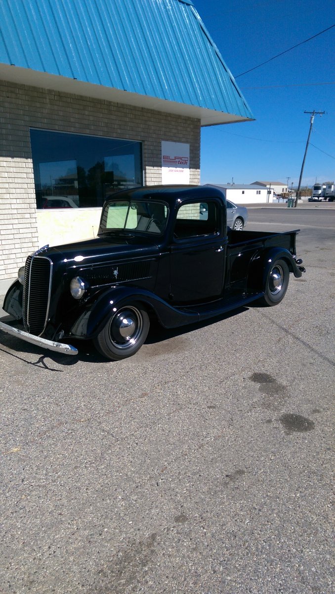

    here's my old '37. dropped axle, reverse eye springs, some leafs removed. On the right bump, the front wish bone would kiss the frame... my phone 1157.jpg

    Here is my daily. 4inch I beam, reverse eye front spring. Parallel leaf rear with a 2 inch block. It will s****e the chin sometimes, but I don't give a ****.
