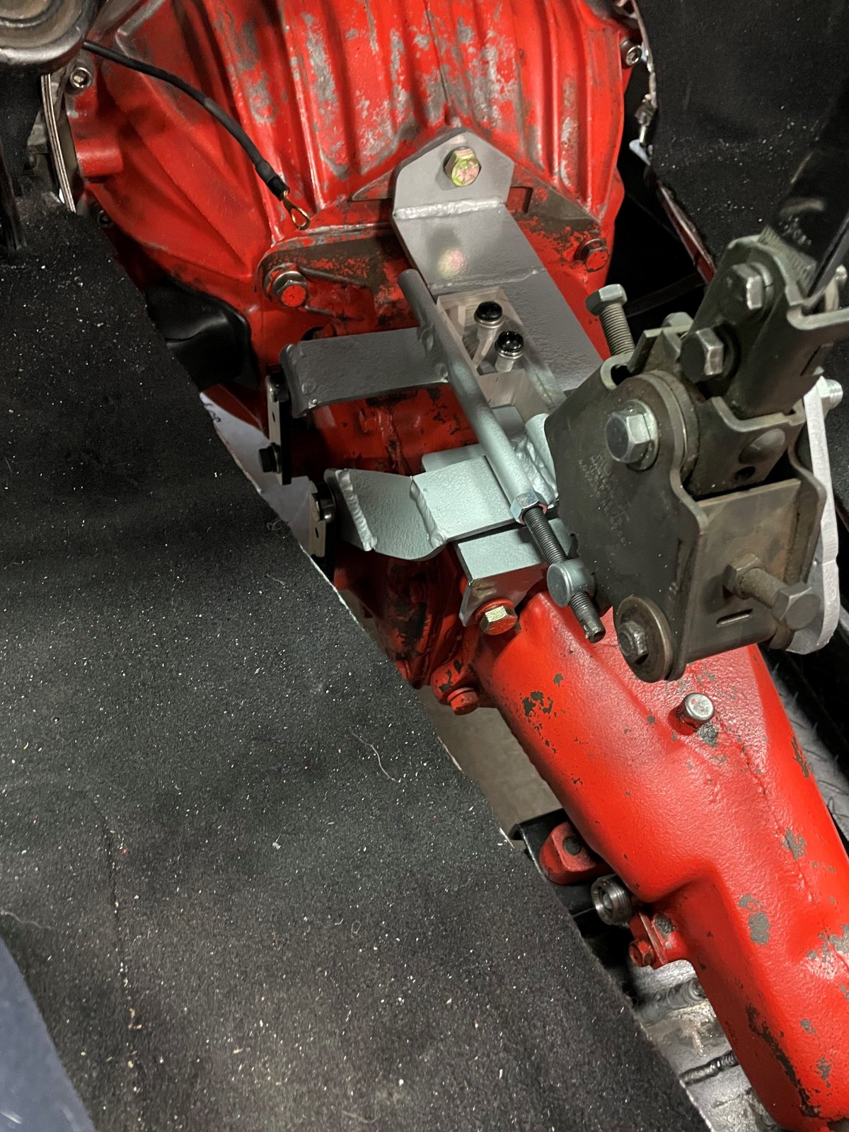

    My roadster has a 3 speed with a custom mount and linkage to move the shifter to the center. 1.jpg 2.jpg 3.jpg

    I used a Hotheads kit. I did need to press in the pilot bushing slightly for clearance.

    Are we on the same page? See the large ring.

    I guess not. I didn't need any spacer like that. I used the stock bellhousing and a hydraulic throw out bearing

    That's truck bell housing. It has the larger register hole in it.
    If you're using a p***enger car transmission, it will fit but there will be a gap, as would be filled by the aforementioned ring.
    If you have a car transmission in there and you have the gap, with no ring to fill it I can pretty much guarantee you that your input shaft is not running concentric with your crankshaft.
    You might get lucky, or you might kill your transmission or damage the rear main bearing, and or wipe out the pilot bushing.

    That makes sense. I got the bellhousing and transmission out of a van.

    The ring is cheaper than the fallout from not having it (if it needs it).

    Then your trans "most likely" has the larger bearing retainer which is another way around it when it comes to Saginaw's.
