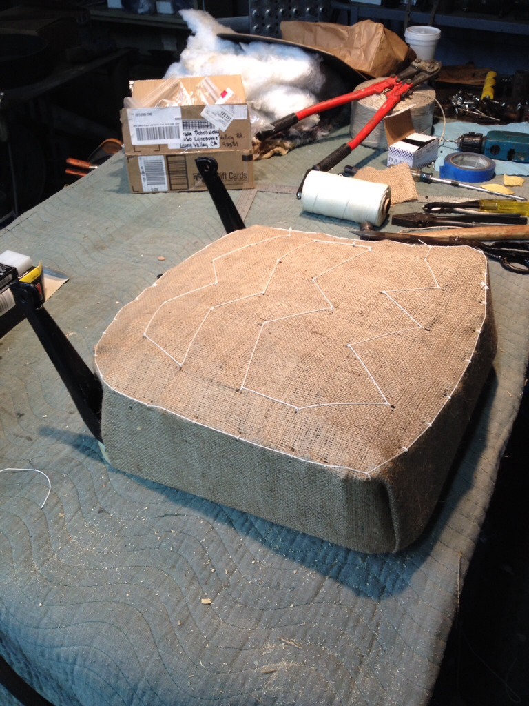

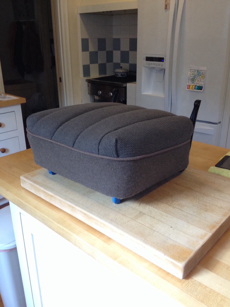

    Cool thread. As a furniture upholsterer for 27 years, I had a friend approach me with a broken "A" seat.
    When you have a seat built for a 40 hp car, then put 400 hp in it, the brackets that hold the back put a bit of extra stress on the seat!
    But we won't toss it, we'll fix it. But still the old timey way because coil springs just work so well and he wanted the original look.
    You'll see how short the original back support is on the right side. The leverage of the back bracket broke the seat frame. So I made a longer leg for the bracket and welded them together. Now we have four bolts in each leg, not 2.
    Removed all the small wire spring from the coils which holds them in place and repaired the edge wire. Then, hand tie them in place making a nice sturdy unit ready for many more years of service.
    Cover in burlap, s***ch it down. Cotton padding, muslin, and upholster...... presto!
    It is cool to bring these things back to life, better than new sometimes.
    Done the original way without glue or foam.
