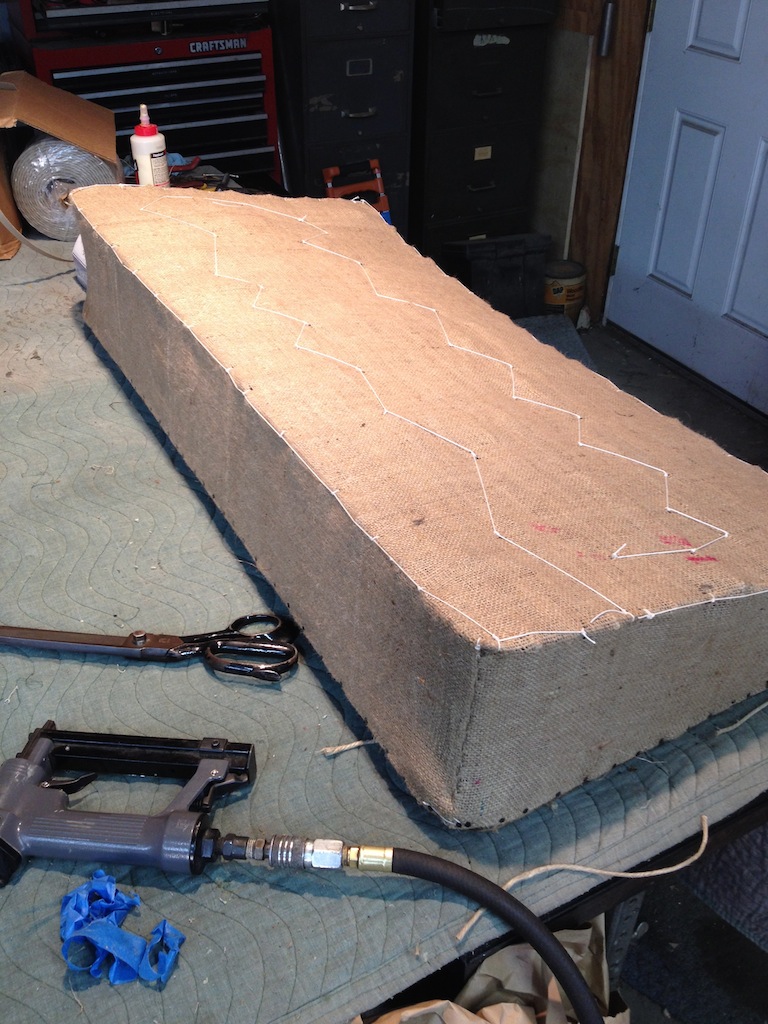

    Here is a 30 Ford original rear tudor seat.
    From the factory, small metal clips were used to "tie" the springs together.
    The wire around the perimeter that all the springs are clipped to is the "edge wire". I remove the clips, straighten the edge wire and re-clamp the springs to the wire.
    I start with tying the springs around the perimeter to control the shape and height of the edge wire. The 2 ties on the front springs pulls them down more to make a firmer edge and some shape to the seat.
    Cross ties fron the top.
    The seat entirely tied 4 ways. Wrapped in burlap and s***ched.

  21. The s***ching part is so the burlap doesn't move? and is there a way to s***ch it or just catch the coils across?
    So you kinda of make a seat frame to go into the stock wooden frame.

    "The s***ching part is so the burlap doesn't move? and is there a way to s***ch it or just catch the coils across?"
    Exactly. The next thing that will go on is a thin dense padding, then cotton in this case.
    You want your platform to support this padding so that it dos not "sink" into the spaces between the coils over time. The network of jute twine helps make the spaces smaller. Then the burlap covers those spaces. So the burlap must be well supported and held in place.
    In this case, the burlap was tacked to the base, s***ched. Then the padding, layers of cotton which were laid in certain sizes to create a shape to the seat, cotton around the "band" of the seat and then covered in muslin. If everything goes right, the seat should be almost perfect in muslin so that the cover is not being stretched to create the shape of the seat. That is what the muslin is for.
    There is a special s***ch and my hands just know how to do it with my brain turned off ;)
    Maybe I can make a diagram to show you. It is an important s***ch used in many places during the process.
