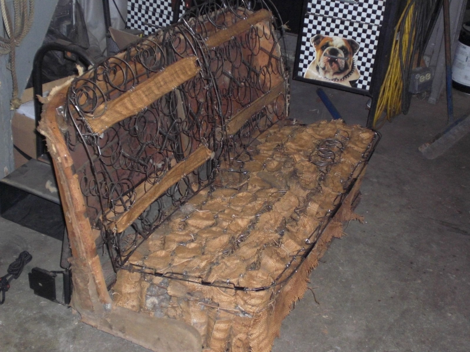

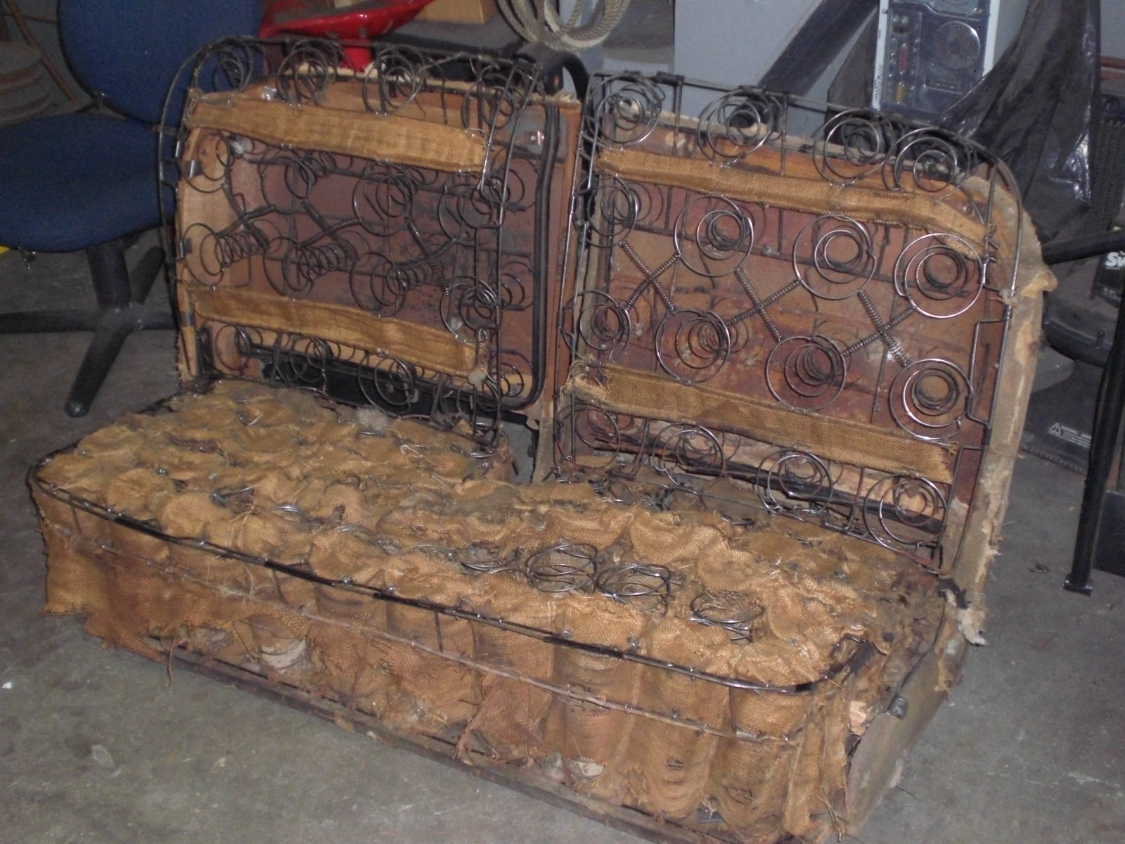

    Model A 004.jpg Copy of 31wks 025.jpg Im in the middle of building an original shapped style seat out of new materials for a 33 Plymouth. Think its going to work out well. Using the zig zags and the base flips up.

    Model A 002.jpg Model A 001.jpg Well its going much slower than originally planed. I've been ultra busy with the Hamb Fathers day seat offer on the OHamb O'dex. But I did spent a good amount of time Saturday removing the old outer upholstery. Had to mask and glove up to keep from breathing the mouse and rat **** that was inside... Man o Man what a mess! Anyway Ive decided to keep the original frame work and build a newer style spring frame that will be the same size and shape as the original springs it will be much stronger with zig zag springs but will still be look like nothing was improved. Hope to do more on it next weekend.
    This is the same seat as the first seat pics in this thread...

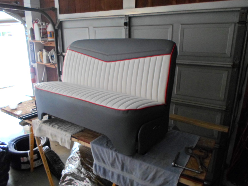

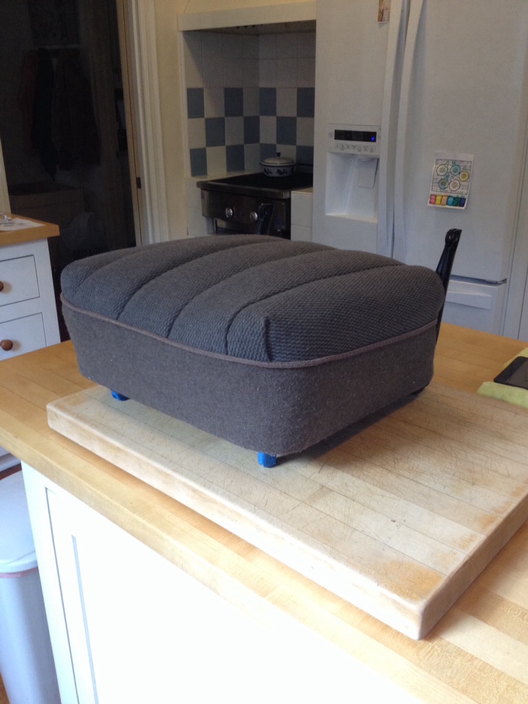

    This is an original 1947 Plymouth seat frame.
    First thing I did was retie the coil springs but I pulled them 2" more than stock. ( I will be using 2" of foam to pad the seat and the seat cover has a 1/2" sew foam. ) Then I covered it with Burlap using hog rings and stretching the burlap rather tight. Next I covered the burlap with 40oz ( about 3/4" ) automotive grade jute carpet padding. Then I applied 1" thick firm high density foam using glue and wrapping the front and side edges about 4". Next a 1" thick medium firm high density sheet of foam was applied wrapping the edges about 4". I use an electric knife to taper the foam around the edges then use my grinder and 80 grit to give it the final shape.
    If you need to ad more resilience to the seat, ( I weigh 320lbs ) you can use stake wire http://www.wsusol.com/p-729-spring-stake-wire-w-paper-1-yd-16-ga.aspx. Cut lengths of stake wire long enough to go across the seat ( long ways ). Place them about 4" apart. This will help distribute the weight and work on coil as well as no sag. http://www.wsusol.com/p-732-spring-120-ft-roll-no-sag-spring9-ga.aspx

    beauiful seat you have there Jim... I noticed it on the "show us your finished seats" thread. Love color selection, deep v white on grey with that red piping knocks it out of the park in my opinion. Thanks for the post.

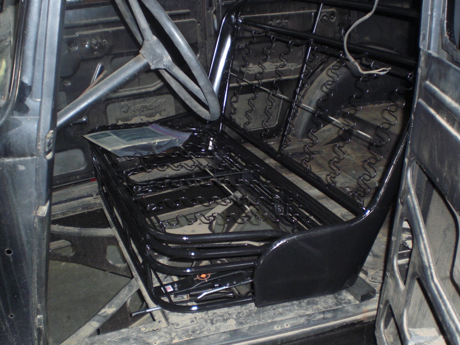

    this seat used zig zag front support springs.

    Good point and that is a nice set-up. Earlier seats that switched over to zig zags were made that way to retain a spring edge.
    My reference was regarding some of the new hot rod seats which use thicker foam to attain a soft front edge.

    Thanks... The owner picked out the colors and I have to say he was spot on!

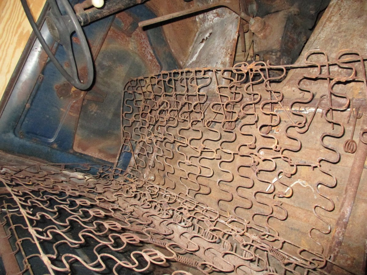

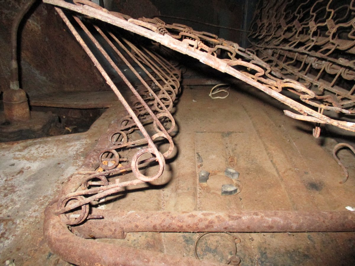

  26. I know this thread was last active in 2014... I have a 1941 Willys pickup and I would like to rebuild the stock seat. The pics in this thread have been very useful and I note that the construction method used by Willys is not quite the same as the other manufacturer's shown. The seat bottom uses a tubular metal frame that hold about 14 formed wire springs. The wire is first formed into a pair of torsion springs to support the front perimeter wire edge, then is formed as a zig-zag from front to back, when it reaches the back wire edge it switches to a torsion spring that attaches to the tubular frame. The seat back appears to be made up of paired zig-zag springs formed into Y at the top edge and bent into a V at the lower edge.
    Question: 1)If I can get one of the bottom springs out intact will a spring company make these for me without costing an arm or a leg or should a make my own jig to make them myself - the wire is ~0.17" diameter
    2)I have no patterns or example to look at for how the coverings were attached(all gone when I got this truck). Is there a standard method? The back and bottom frames are rigidly connected, the whole seat flips forward about the bottom front edge.
    Thanks for any help
