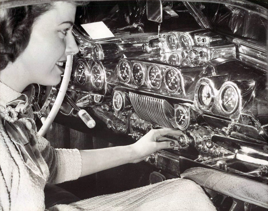

    Major Tom to ground control. :D HRP

    Sorry, the judges have scored a digital dash as a single gauge... ;)
    I 've seen that before and I always wondered how many of those gauges (and switches!) actually function.

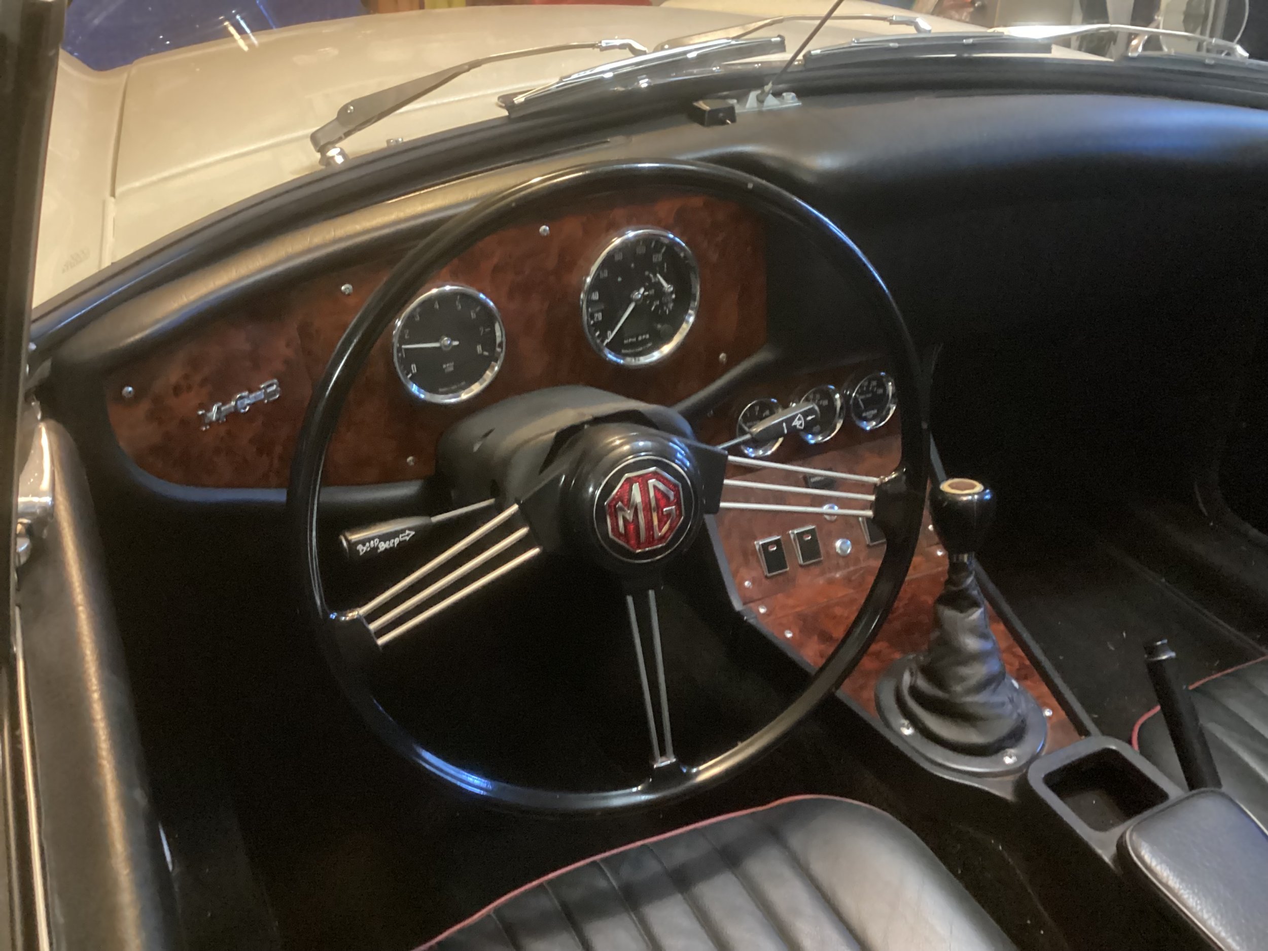

    I wanted Less gauges in our 1970 MGB, plus I wanted to get rid of all of those non-working Smiths gauges. Over the years I purchased many “working “ stock gauges only to find them not work once I installed them in our car. I also couldn’t stand the plastic looking stock dashboard, so after looking for many months at many manufacturers gauges I finally went with Speed Hut gauges and am pleased with the results. I cut out the old dash and fashioned a wood dash with veneer to get a burled finish. The console received a standard set of Stewart Warner mechanical gauges. The speedometer which is GPS, combines gas gauge, turn signal indicators and high beam indicator. It required a 12 volt hot wire, ground wire and sender wire for the gas gauge. The old tank sender was replaced with a printed circuit one and the gauge can adapt to 20 or so sensor voltages. The new tachometer works with 4 cyl, 6 cyl or 8 cyl. It was expensive for my tastes, around $500 five years ago, but it is a joy to know how fast you are going, how much gas you have left and the temperature, oil pressure and charging are working. Everyone who looks in the interior appreciates the real wood and simple design. Last to accomplish is to take the vinyl off the door top pieces and veneer them to match the dash. I also removed the small leather and spoke with holes 70 steering wheel and adapted a 1969 banjo model to the spline. The larger diameter makes slow speed turning easier with the manual rack and pinion.
