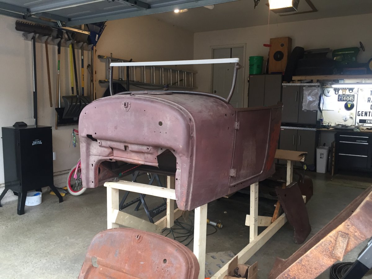

    Just got this body. It will be going on a ch***is I have been building. Pic in next post.

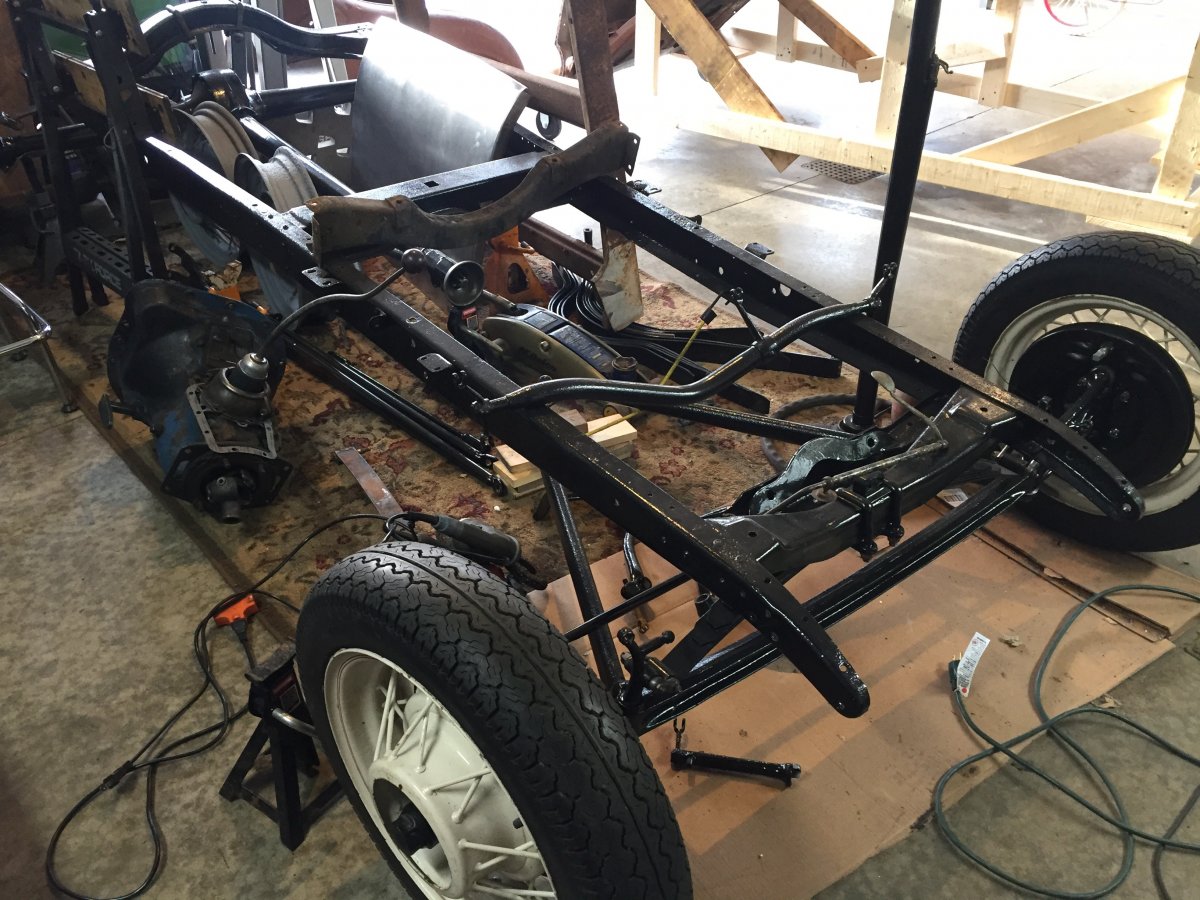

    A frame. A rear. Mix of front end parts. A motor. B trans.
    Question: this body came with new sides, pictured. Is there supposed to be a sheet metal piece that picks up where I am pointing and covers the side of the subrail back to where the fender starts?
    Thanks,
    Scott

    yes it goes all the way around the wooden subframe/ turtledeck floor under the deck....[​IMG]what was wrong with your old 1/4's? they looked pretty good ...how come the new 1/4's are so much shorter on the flat area at the very top behind the door?

    Actually, Scott, there's a subrail that runs the perimeter of the rear, (roadster and roadster pickup, I'm pretty sure) the roadster's 'bustle', or 'poop deck' fits on top.

    Old wuarters were touring with an actual roadster back section grafted in. i think the flat area only goes that far because wood is supposed to come up that far. It was flatter on the original one because it was a touring which would have been flat all the way back but had a crude ‘recess’ put in to look like a roadster. I think the recessed area is where the wood is supposed to be right? Also, the subrails are cut just behind the first cross brace. I got the back part of another set of subrails so I will have to trim accordingly and weld them together. Nailhead, where is that pic from and what the heck are they called? I have been searching for them but didnt know what they were called.
    Thanks,
    Scott

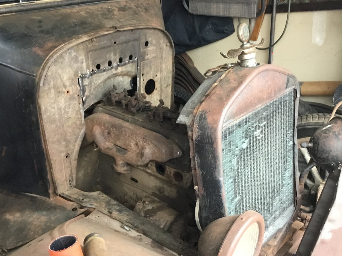

    Pulling out the engine with the Rajo and installing a Himico built engine with Himico 3 speed sliding gear transmission and Himico High compression head. IMG_0433.JPG IMG_0433.JPG

    Mike's correct, the subrail is the same gauge as the rails under the rest of the body. It's the same, roadster or
    roadster pickup.
