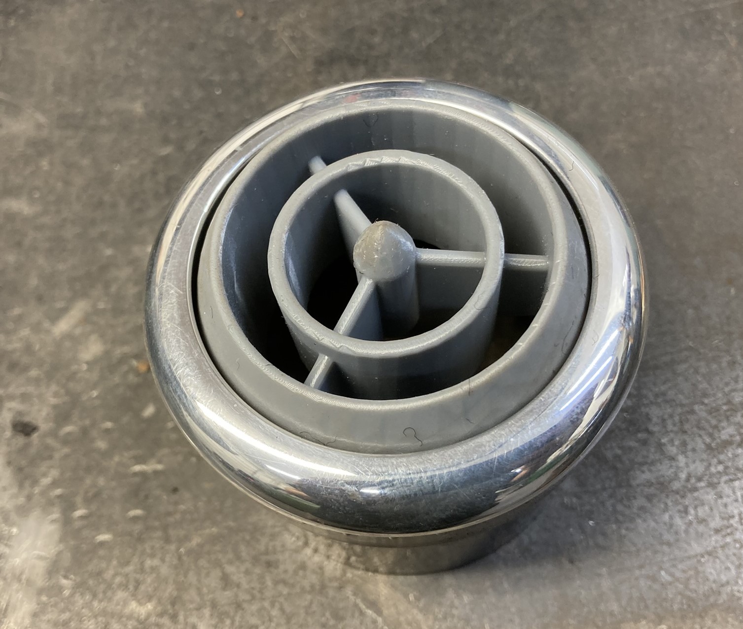

    I've been learning Fusion 360 for a while now. Here's a horn ****on I designed and had printed in stainless, and a prototype A/C louver ball to replace the generic ones in a lot of aftermarket stuff.

    Anderson: what filament and printer did you use.
