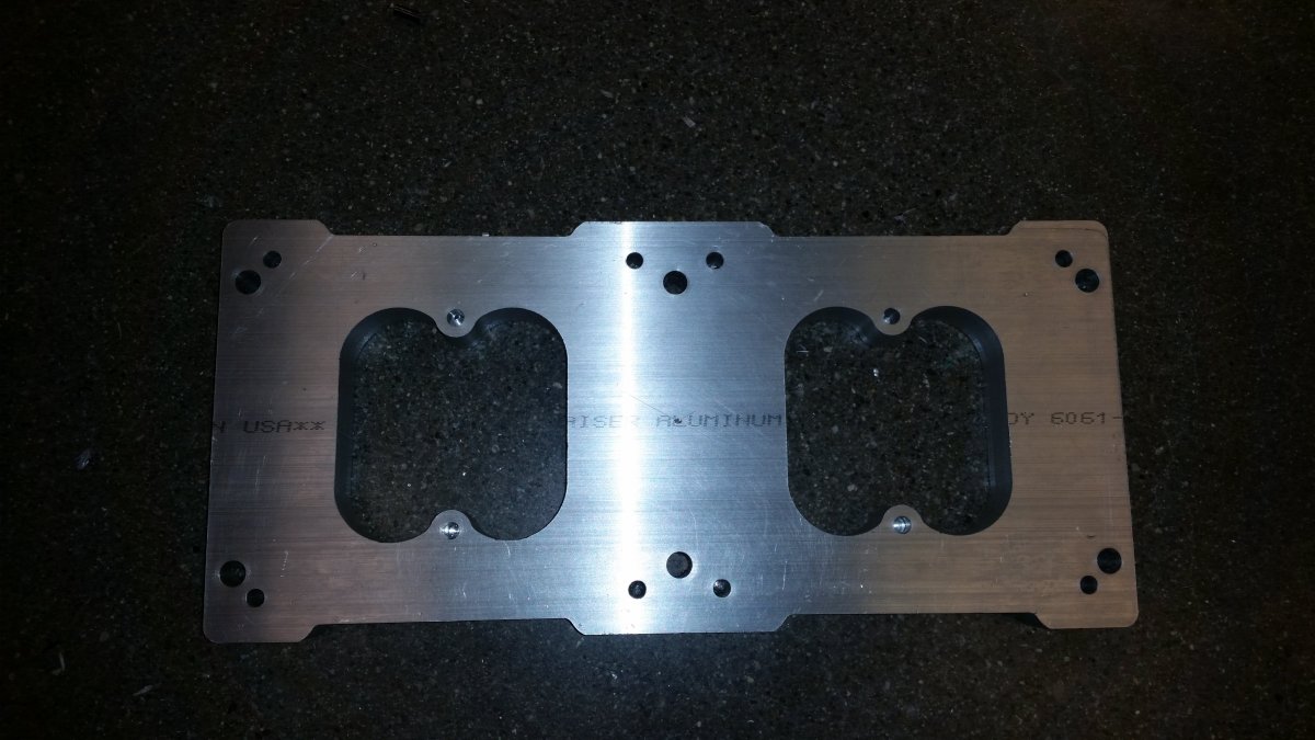

    Today I accidentally milled out a boost referencing 6-71 to Edelbrock carburetor (design thanks to @ago ), at work.
    Don't worry, it will be deburred, dressed with a file, and all non sealing surface sandblasted, so it looks cast.
    I still need to counterbore the case bolt holes, if I can find my damn counterbores.
    USA sourced aluminum, too!

    Gimpy, You probably know this already. Make sure you epoxy the secondary vacuum notch of the carb. It lets the vacuum source the power valve metering ports of the carb. You want to isolate the metering port from the intake manifold. The end result is have the power valves of the carb get its signal from below the blower. I used a 4 hole carb gasket and punched two small holes under the metering port.

    My intake manifold had 8 holes, I cross drilled the two metering holes, and connected a 1/8" pipe fitting and ran tubing down to the blower manifold.

    Yup, I learned it from you!
    I made mine open center, in case I want to up the carburetor size. I looked up the biggest Edelbrock, and sized it for that.
    I will cut a stack of custom gaskets on the laser cutter at work.

    I gave up looking for my counterbores and dropped it off at my machinist, after work. He's going to finish it off tomorrow.
