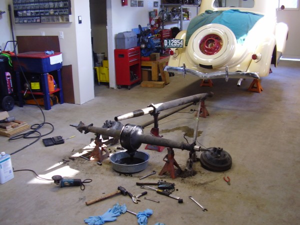

    The Banjo became obsolete for heavy drag cars about ten years before dragsters stopped using it...weight is a big deal, and became important as the new OHV's pushed normal displacements past 300 cubes and kept going UP.
    What broke in the pictured one?? I have poor picture resolution, looks like welded spline came out of driveshaft??
