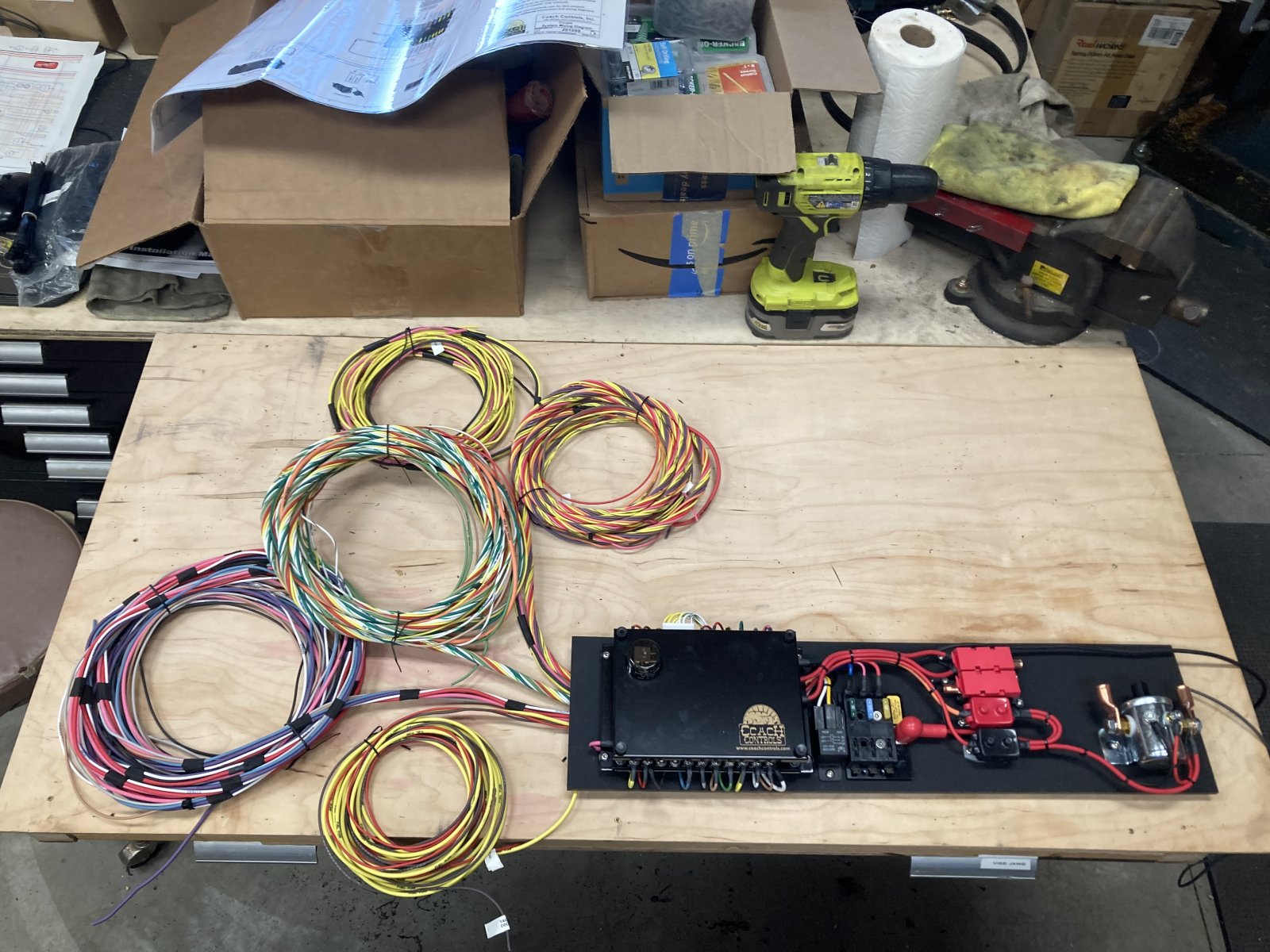

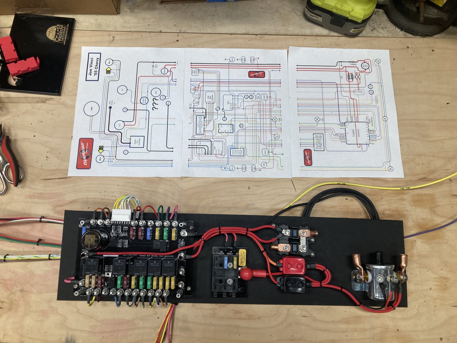

    One could purchase a kit from any of the usual vendors and get it done over a weekend, but that would be a quick and dirty, plug and play job where nothing is trimmed to suit and everything is left terminated as-is from said vendor and the excess wiring tucked away. You see this a lot and it usually results in the mess that you're probably picturing.
    A wiring job where everything is routed cleanly and terminations made from scratch would take 30-40 hours as others have mentioned.
    I'm about halfway through a job now that will probably come in around 50-60 hours, but that's with about 10 "on the bench" building the panel, concentric twisting, bundling, and drawing the diagram, etc. Everything will get wrapped in loom once in the car.

    Where did you get your wiring kit?

    Coach controls is very nice stuff.
    32blownhemi and Bandit Billy like this.
  8. PotvinV8
    Joined: Mar 30, 2009
    Posts: 550
    PotvinV8
    Coach Controls
    Agreed!
