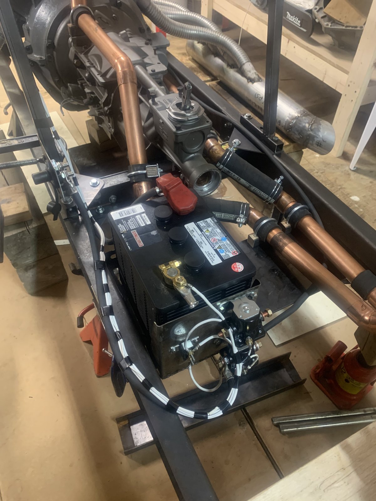

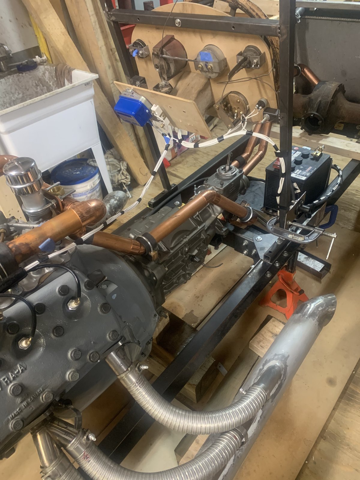

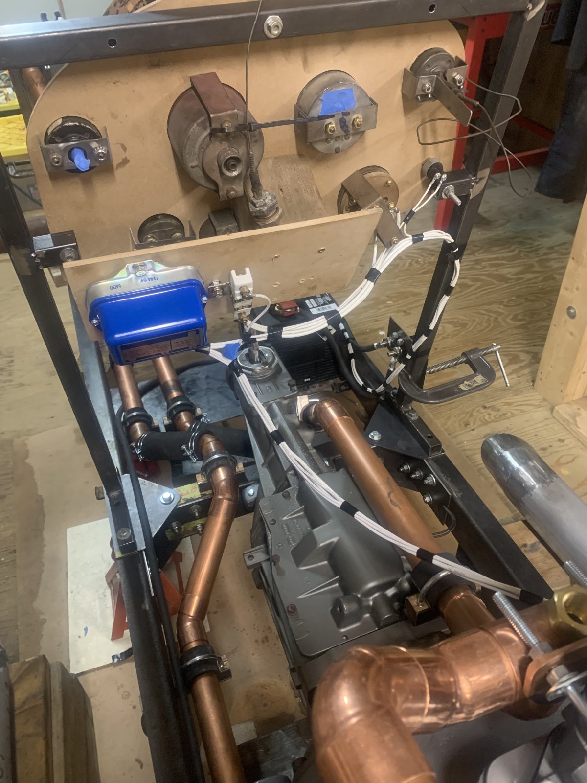

    I hate to admit it, but this simple harness took me a few days to wire up. Not full days, but still…and it’s not permanent, only for start up, but wanted an idea what it will kinda of end up like in reality.
    32blownhemi and bobss396 like this.
