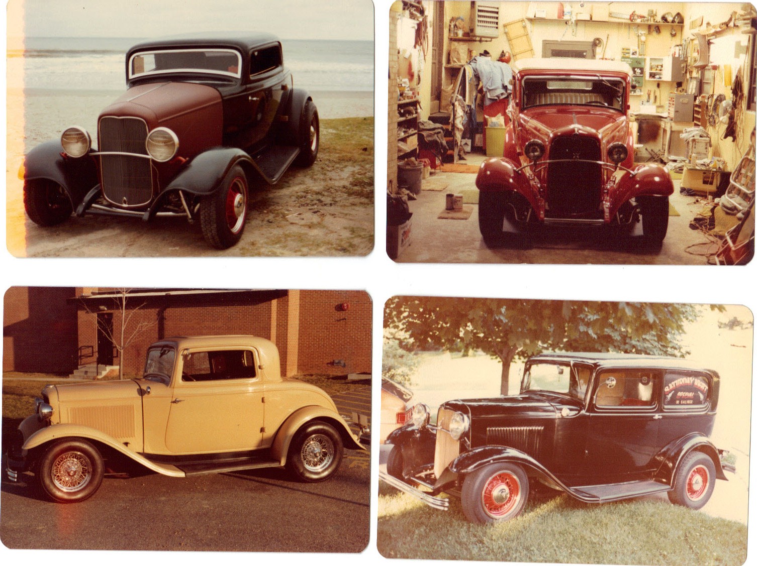

    Hey, 32
    Since 1957 I have wired about 90 street rods. Most were loaded.
    Back in the day, I would snag the harness from the donor car.
    I use a Ron Francis kit.
    I am a Master Electrician in 23 jurisdictions.
    DO NOT, DO NOT try to scratch wire your '32.
    Jim, bangin' on old cars since 1957
    410 474 2244 cell, 410 535 1933, 410 535 1932 37WR electrics.JPG IMG_1729.JPG our '32 Fords way back.JPG
