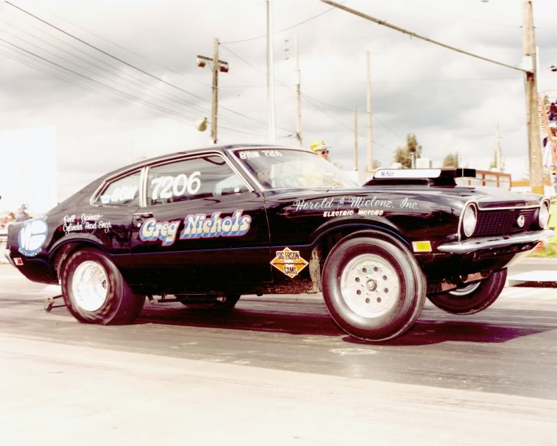

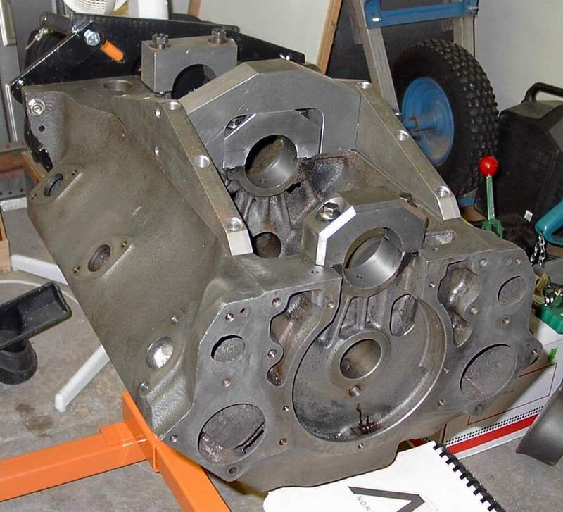

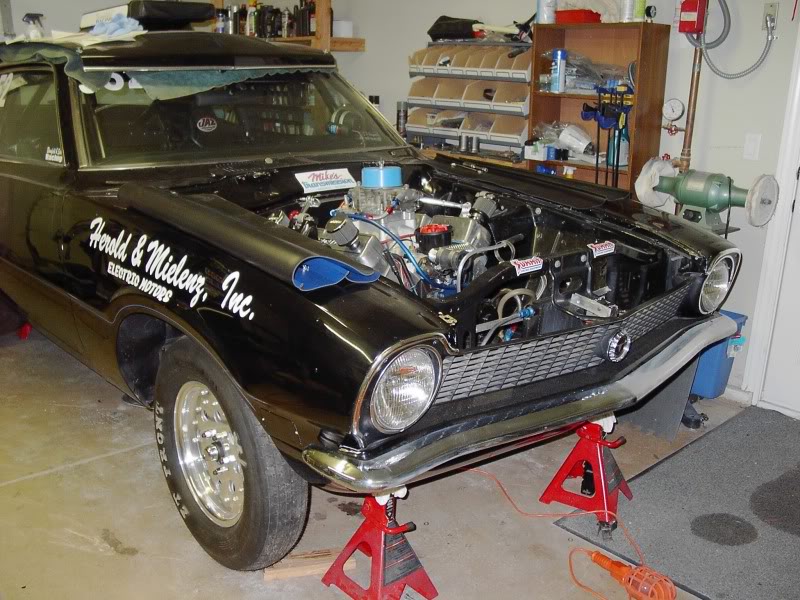

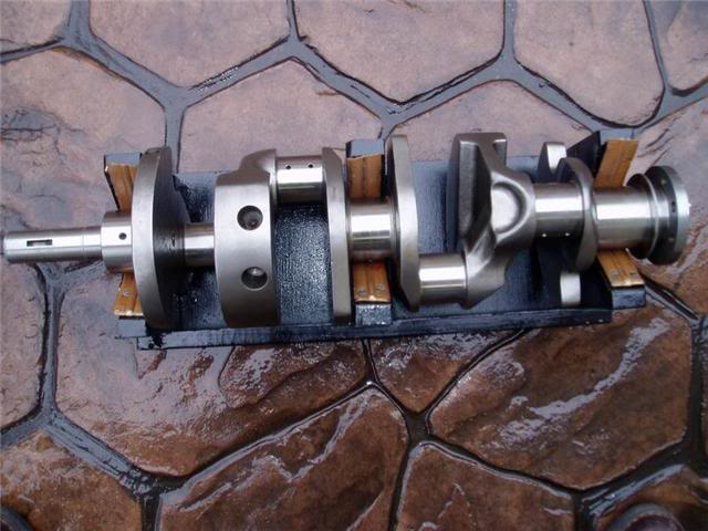

    Here are some pictures of the motor I started..............and planned to make 300HP at the crank.......................and I spent around $10k....................now I am building a new motor for my Ole 1970 B/SM Maverick..........last year it did 9.901 @133 in the quarter.....and the car with me weighs 3325lbs...................for about the same price as the flathead motor I plan on getting into the mid 9's...................The flathead motor is truly a labor of love, and the old saying that has held true for the 30+ years I have been in drag racing is still true, "How fast you want to go is directly related to the amount of $$$ you spend". Oh, one more thing, you need to pay extreme attention to detail, like the crank which is 4.125 Merc stroker that has been nitrid'd, shot peened, and index'd, not to mention the **** I beam rods that were resized right out of the brand new box..............and the Ross pistons that were lighten and have lightweight tool steel pins.............I still have the short block and when the Maverick is finished I will put this motor in a little short wheel base drag frame and will turn in the 12's with carb's....................I hope.
