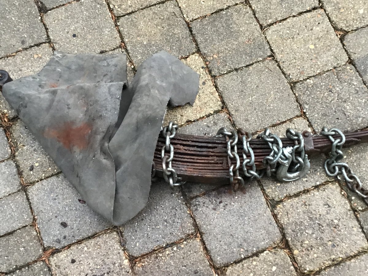

    I am playing with a 1932 ford truck and the front needs to be dropped a bit. So I pulled out the front spring and to my surprise its a 12 pack leaf spring wow stiff ride. Now this is a 32 that hasn’t ever been apart and low mileage and crazy as thats 89 years..
    So just cleaning up the spring and be careful when taking them apart as they have lots of energy in them and will do LOTS of damage to Flesh teeth and bones. I wrap mine in a chain and leather and cut the center bolt. This one is super nice so it will just unbolt and still wear full face shield leather gloves and apron “safety first please”.

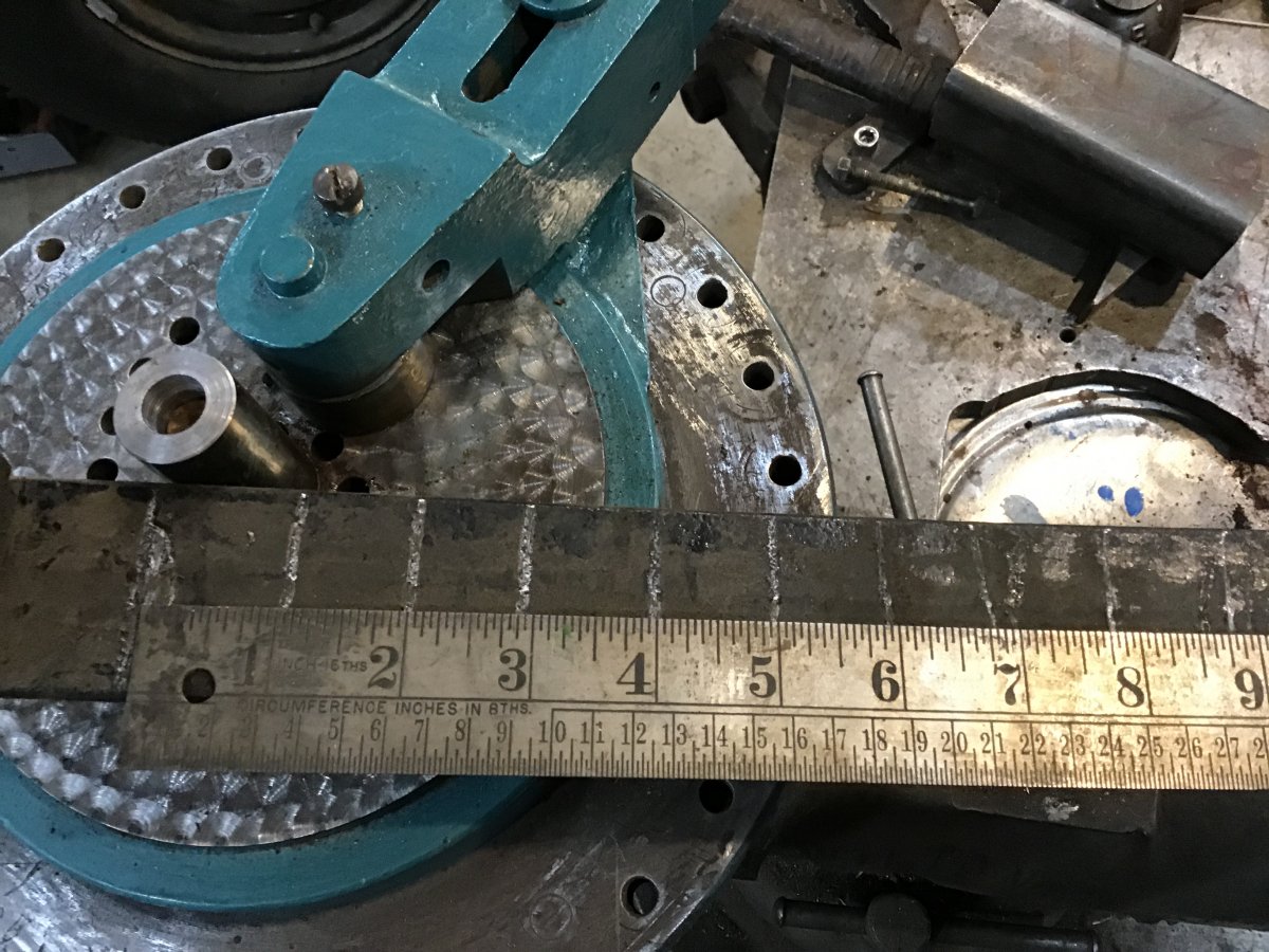

    So I pull the spring pack apart and then mark on the ground the arch I will achieve after changing the direction of the spring eyes. I mark the spring on the new top side of the spring every inch . I then put her in the simple but very effective jig and put a bottle jack in the center and put a load onto the spring. I do this every inch but be very carful around the spring bolt hole. I have broken a few of them and dont bend a inch of it. . So i will do this a few time till I get the spring reversed and takes about a hour . I am doing a few of them today and like to have one on hand if I need it .. 1B09665C-48F8-4733-9ABF-27CC75822056.jpeg C110C082-7C3F-4EE6-9661-79A3062A8546.jpeg A72647D9-82D1-478C-8B93-5973569ADE1D.jpeg 1282174E-380F-4957-AD29-8983452352A9.jpeg 033FE522-3293-420E-B54F-10DCFE23CA95.jpeg image.jpg
