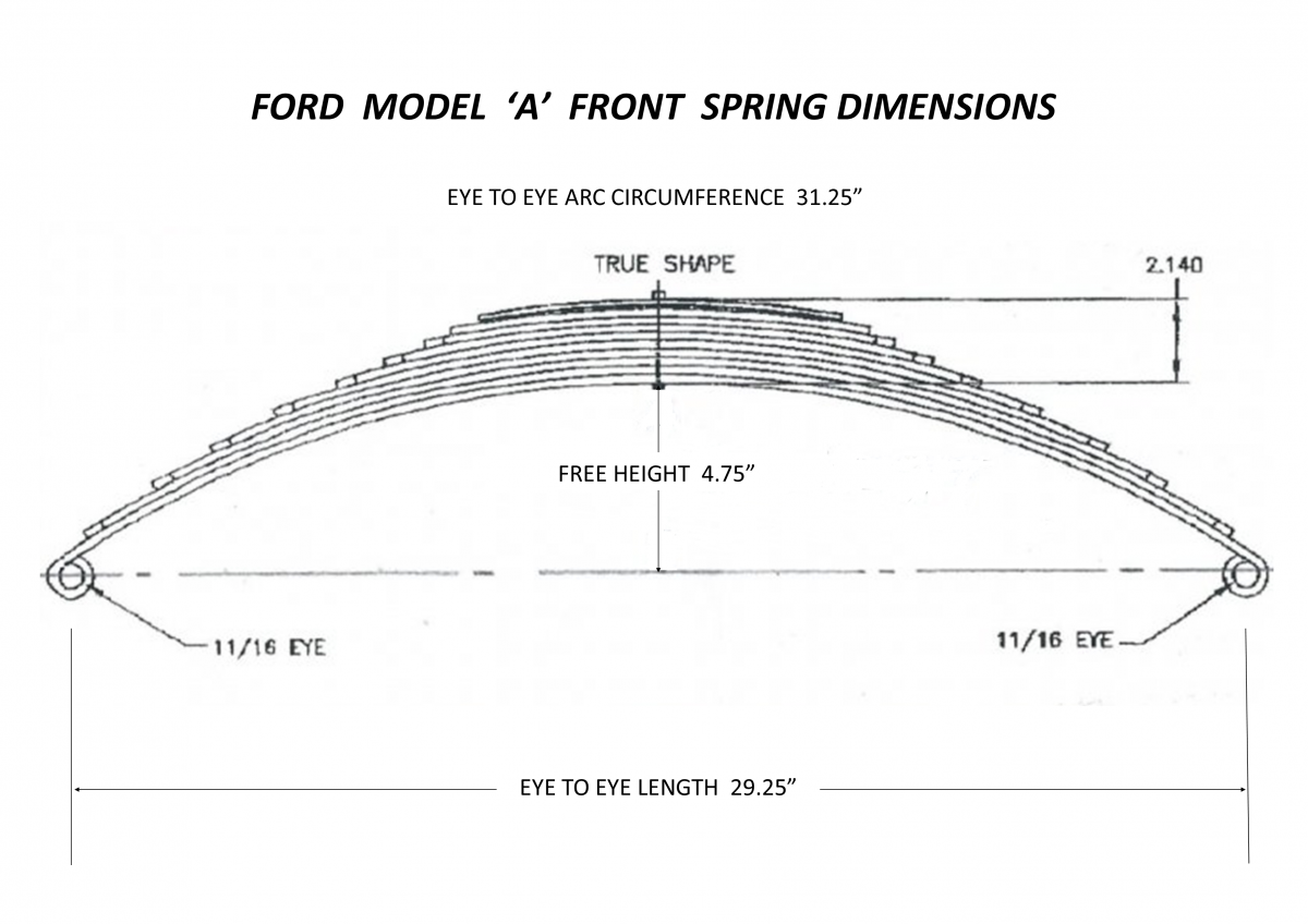

    There is so much said about correct shackle angles on a front transverse leaf spring. I just wondered if the length difference would affect this. I have no idea how much a leaf spring lengthens eye to eye by de-arching. Some "sagita" calculations may be in order. If I get time to do this I will post up the results for all to see.
  6. twenty8
    Joined: Apr 8, 2021
    Posts: 3,720
    twenty8
    Ok, how much does a leaf spring lengthen when it is de-arched? Here are the answers.
    Let's start with a standard Ford Model A front leaf spring. The dimensions shown on the diagram may not be dead accurate, but they are very, very close.
    Using arc and 'sagita' calculations gives us the following results.
    Free height reduced one inch to 3.75" will lengthen the eye to eye dimension to a shade over 30".
    That is 3/4" longer overall, or 3/8" per side.
    Free height reduced two inches to 2.75" will lengthen the eye to eye dimension to 30.6".
    That is 1 and 3/8" longer overall, or 11/16" per side.
    This looks like it will definately have an effect on shackle angles.

  7. I got an idea that the equation used to produce the information produced did not take stretch into account. To determine that one would need to know the material used, plus material thickness plus method used. For example while I have not measured and compared, but I have an idea that the hammer method (my preferred method) probably produces more stretch than say the press (either hydraulic or mechanical) method.
    Next one must determine what the actual adverse reaction to the change in shackle angle is and why that is important. As you shorten the spring the angle moves toward 180 degrees. But you would have to shorten the spring a long way to get there or as you lengthen the spring you loose numerically, the suspension will still work it just will not travel as far. This could be a serious problem on an off road vehicle not so much on a street vehicle. I think that the most noticeable change is going to be in ride quality. One may note that removing leaves does cause the spring to flatten out, that is how it gets lower, again a loss in ride quality will be may be noticed.
