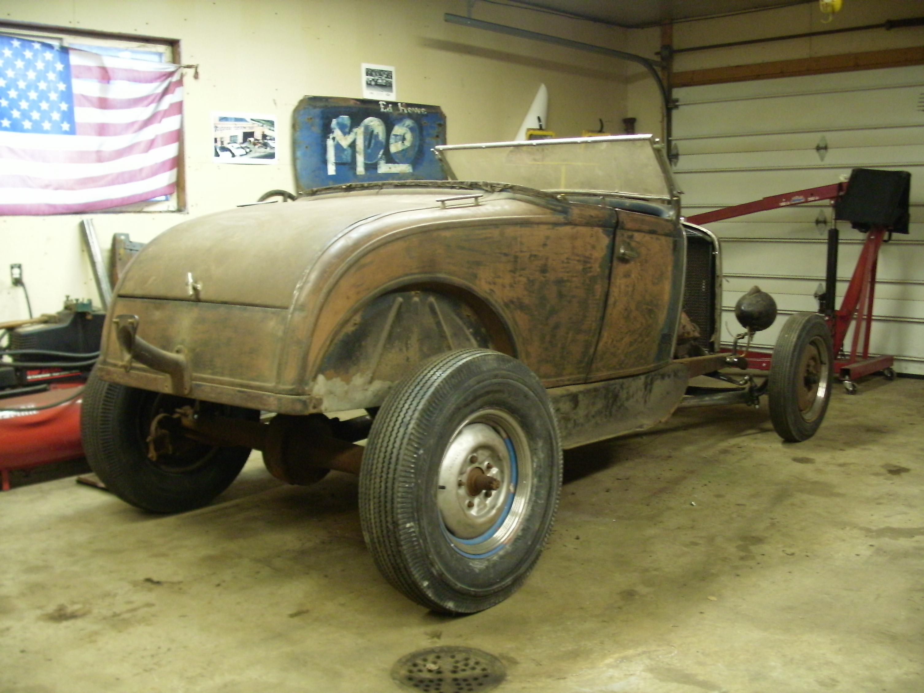

    Lucky77
    Here's a before and after on my roadster. The first pic is with a reversed eye Model A spring. The second is the same spring with the top three leaves removed and cut down to 12" long each then placed in the bottom of the stack moving the main leaf up. Probably lowered it 3.5"-4".

    I've heard about guys doing it this way...are the 12" leafs on the bottom of the stack long enough to get all the way under the U-bolt blocks?
