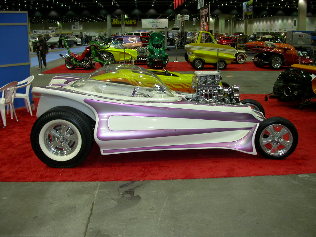

    23 years for these with no leaks,(true no real miles on them but they don't leak) they are Radirs. I just went and looked, it does not say tube type on the tire so maybe they are meant to be tubeless
