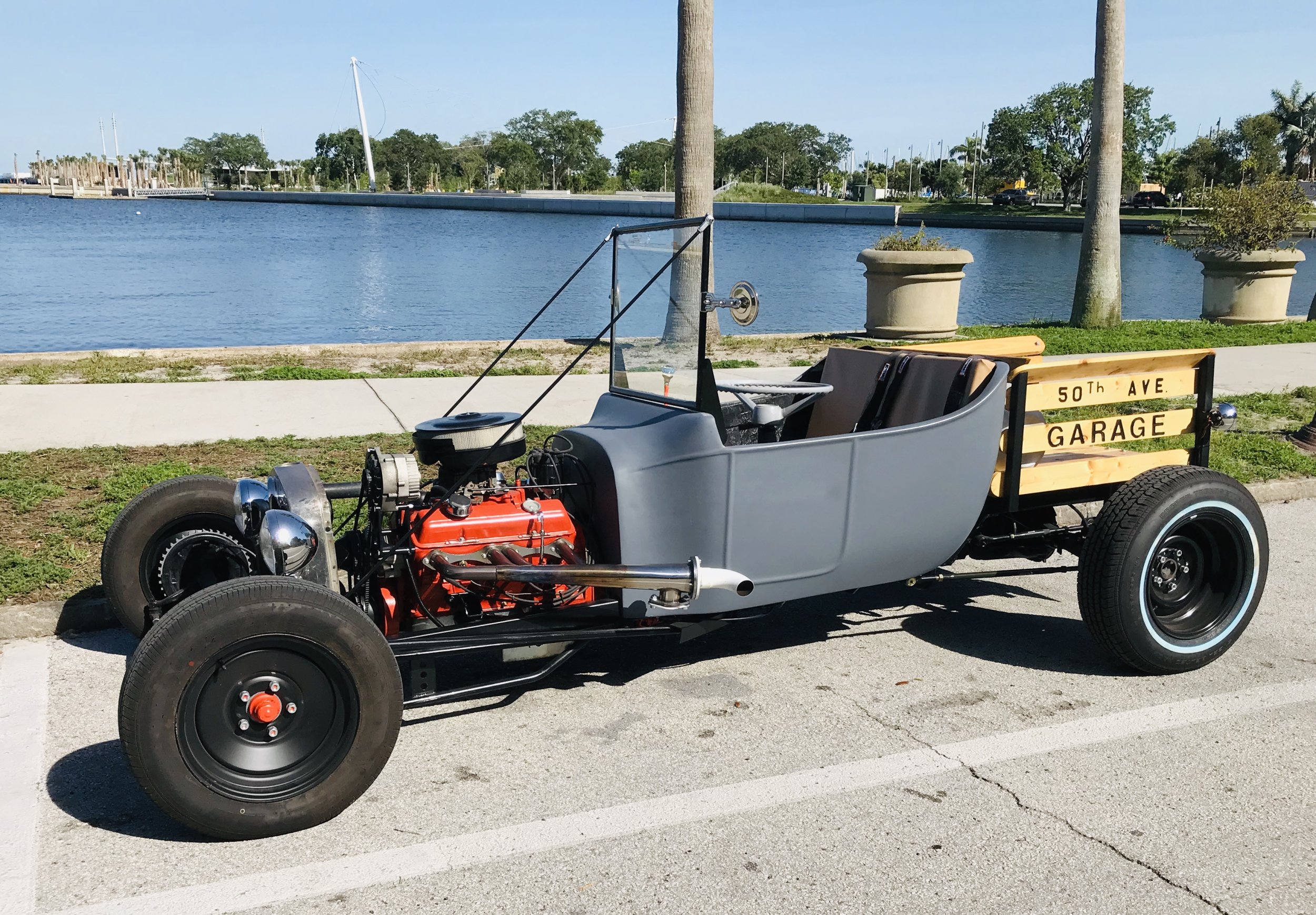

    I built my T Bucket frame and suspension parts with an AC stick welder and 6013 rod. 17,000 miles so far with zero problems. IMG_0391.jpeg
