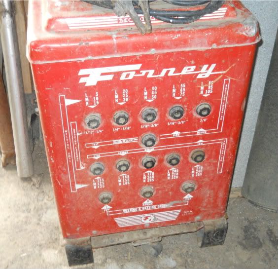

  3. Mr48chev
    Joined: Dec 28, 2007
    Posts: 36,519
    Mr48chev
    I bought this Forney from a Trucking company in the early 90's and with the right rod it will handle any serious welding you need to do.
    If your shop electrical system can handle the amps it can weld about anything with the right guy using it. How clean and nice the welds are all depend on the skill of the guy using it.
    Under 1/8=3/16 I'll use the mig as it is easier to dial it in to weld right than it is with the Forney. Over that it sometimes depends on if there is a breeze blowing because the mig is useless with a breeze going on.
    If you are over 60 you probably only saw a mig welder in AG shop in high school up into the 90's. Even then it may have been a three phase unit. You still learned with a stick and graduated to mig.
    The big thing with stick that some of the younger guys can't seem to handle is that you have to chip the slag away every once in a while if you don't get the machine dialed in so the slag will actually curl up behind the weld.
