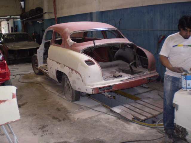

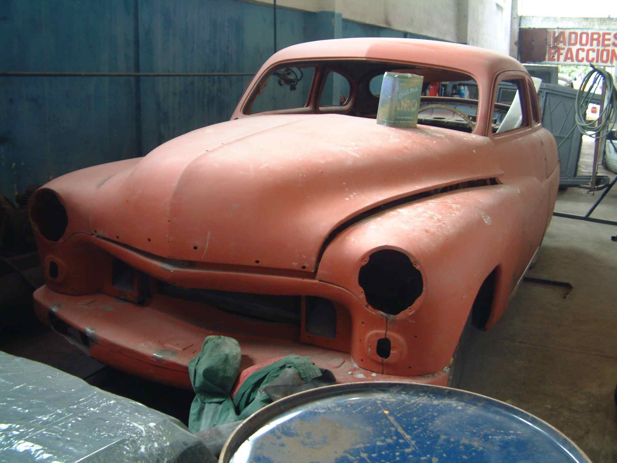

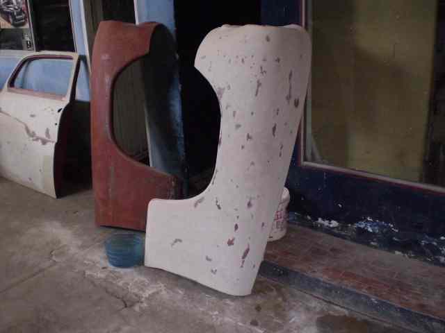

    Had a discussion with the guy from the body shop where my Merc is being prepared for paint. Doors, rear quarter panels, fenders, hood, actually the entire car is being filled with bondo. Body is straight.
    I know imperfections on 60 year old metal are unsaveable but which is the limit for bondo ?
    Of course this things were still not sanded. What do you think ?
    Take a look at the pics.

    ugh.................. was all of that bondo already on that car before they started on it? it's hard to tell from the pics, but i'm trying to figure out why there's so many patches of old paint/primer peeking though in the high spots. or are they low spots? :confused:

    looking at those pics.. that looks like quite a few aplacations of filler, did the shop try and straighten the metal first? or just coat the metal with bondo an sand away, coat, sand? was the body in REALLY rough shape to begin with? could you post some before pics... that looks like alot of bondo, but if it's really thin when their done you'll be o.k.

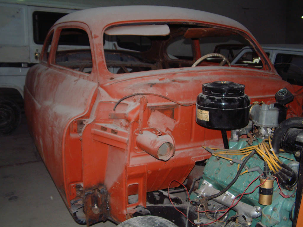

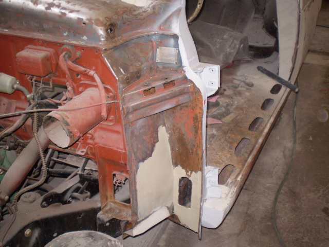

  28. mercjoe
    Joined: Aug 17, 2006
    Posts: 1,448
    mercjoe
    Yes, the metal was straighten and patched, there were imperfections all over but not that rough. The imperfections you would expect from a 60 year old car body.
    Its not paint underneath, thats red oxide which we believed it was better to sand and work over instead of pealing the whole thing again.
    Here some before pics.There was no bondo under the red oxide, just metal
    Thanks guys
