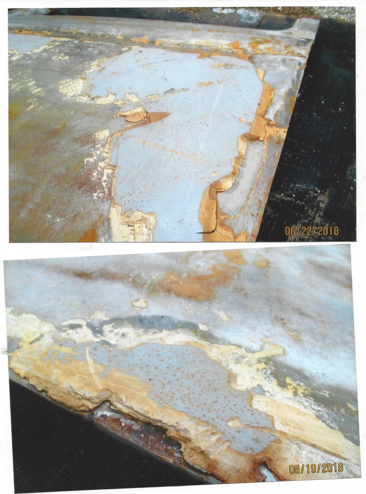

    not mine ^^^ but similar I would think ......
    Where the panel is not in full alignment with the counter of older panels ...... id definitely need a full 1/4" bondo to smooth out the panel transitions ......

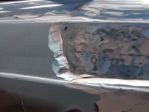

    well heres an actual pic of mine .......
    The lip would be 1/8" to smooth between panels .......... but to align with the other panels better might need to build the entire thing to ~ 1/4" etc patchpanel2.jpg

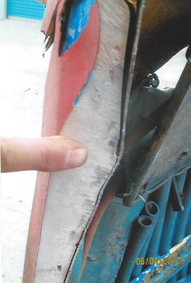

    When I was in the Army I had a '63 4x4 carryall that a PO wrecked and had repaired in Mexico. The replacement p***enger vent gl*** had Hecho in Mexico printed on it. Anyway the bondo around the lower right corner of the windshield was 1/2" to 3/4" thick. I'm guessing that's too much?

    I agree with FlamedAbone, looks like you might be overlapping your patch panels, which you really don't want to do. They should be **** welded to avoid that big ledge. Also, the entire seam needs to be welded, not tacked together like that first picture (I know you said that isn't yours, but that patch is very unfinished as it is pictured).
    An eighth to smooth it out is no problem if the underlying metal is clean. If you know it's going to be deeper than that (like a quarter), give a p*** of kitty hair first, then knock that down until you can blend it all in with a skim coat of filler. If you know it's going to be 3/8" or more, try to work the metal more. Hammer and dolly, cut and re-weld, whatever you've got to do.
