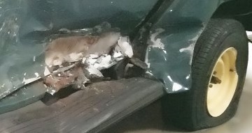

  4. BamaMav
    Joined: Jun 19, 2011
    Posts: 6,969
    BamaMav
    from Berry, AL
    I've got an OT Ranger pickup stashed in the woods behind the house. Before it got rolled over in a wreck it looked just like any other one, afterwards it looks about like these pics. Figure it must have been a rust belt vehicle, the places that broke off were on the bed wheel wells. Whoever did the work was an artist. Couldn't tell it from any other one until the roll over stressed the bed and popped it off in places. Too much for me.

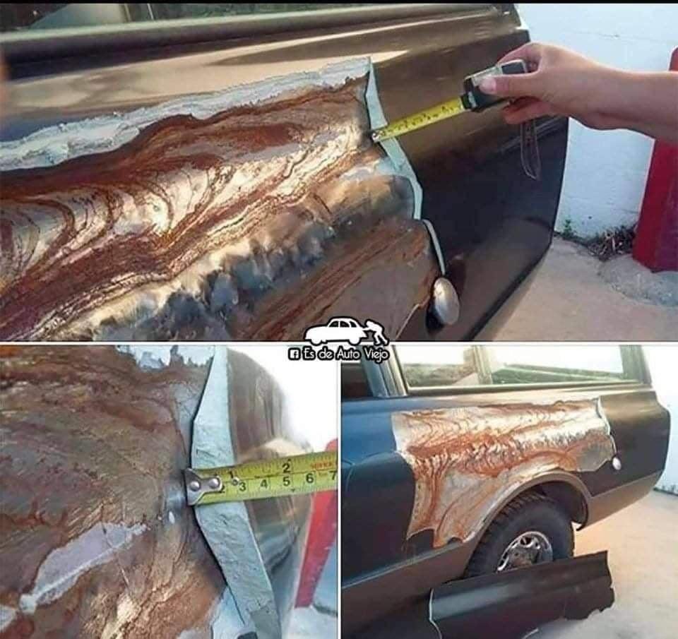

  7. NoelC
    Joined: Mar 21, 2018
    Posts: 669
    NoelC
    That Nova Scotian home boy does what he does, I say don't slag the Chad man.
    Bad Chad aside, they can't all be sculpted in Canada. You guys have to realize it happens down south as well. Judging by the pictures posted since, more often then you realize.
    Judging by the thickness of mud used on some of those sculpted rides, I'm thinking all those fine art degrees found a place in society to earn a living.
