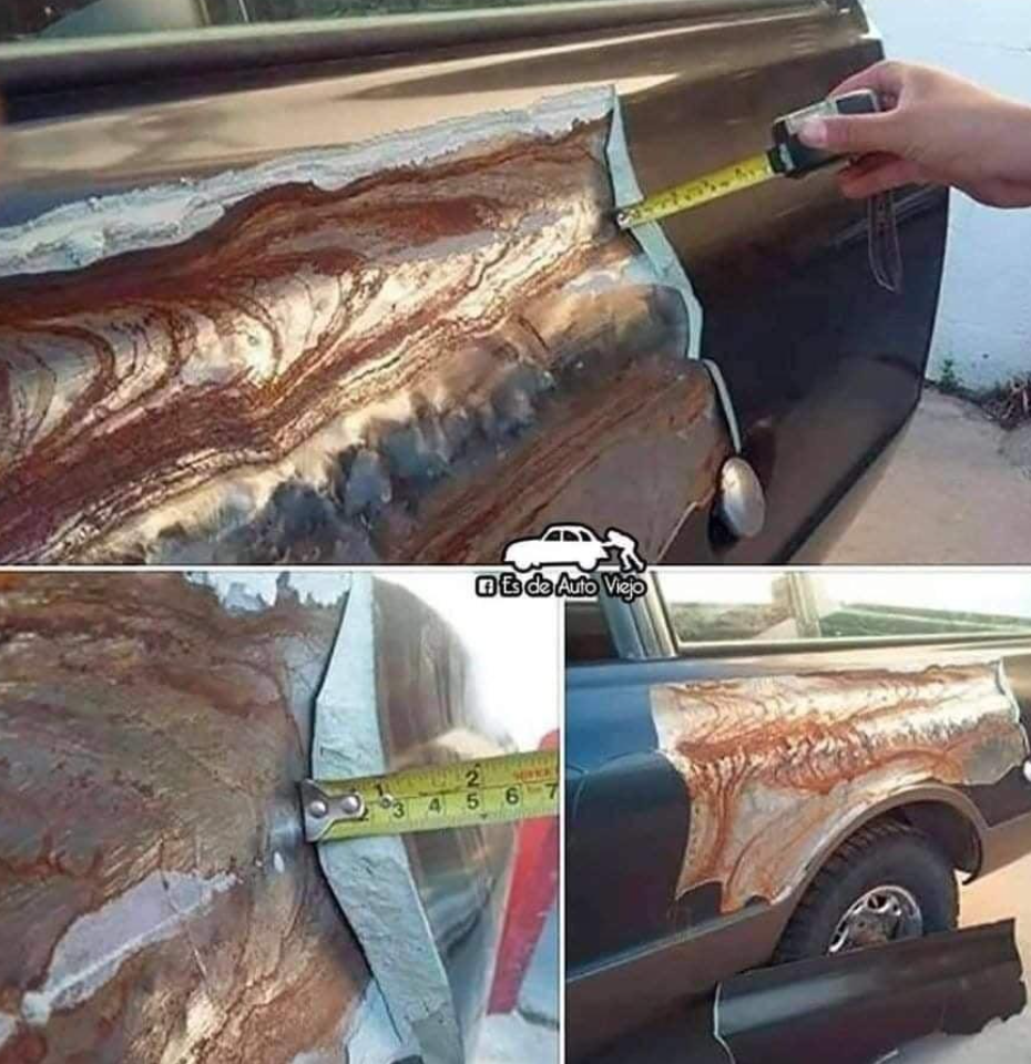

    Did you see how much rust is under that bondo? I can only ***ume that the surface was clean when it was applied. It is for this reason I have always heard that Bondo should be used over the top of epoxy primer. It traps and absorbs moisture as it cures from the outside in, and will rust the steel beneath.
