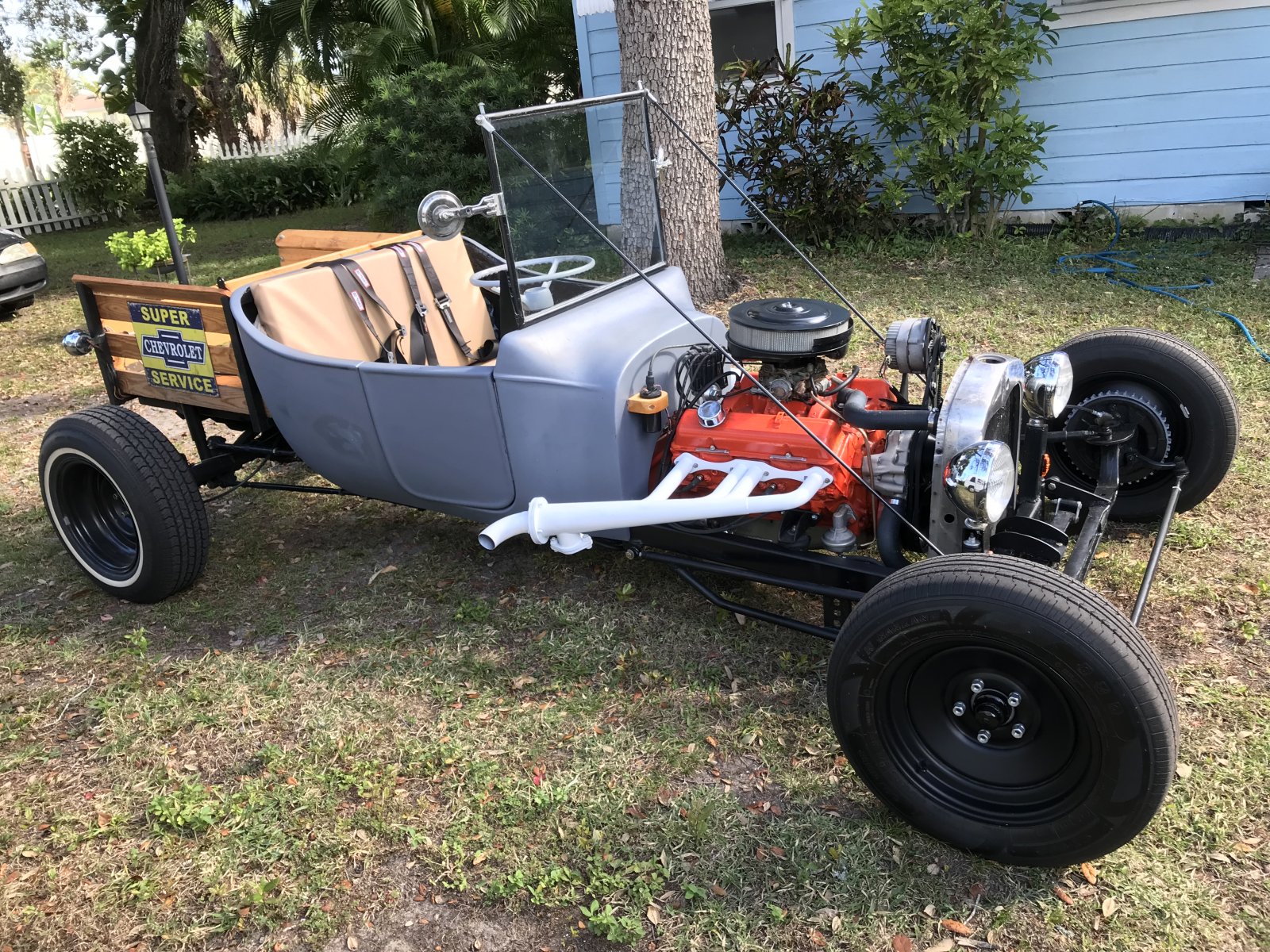

    I too love this post. To me, the wavy panels make it look more like a real race car.
    My car also made the cover of Hot Rod Magazine. I didn’t spend one minute sanding the body. I did spend about 20 minutes with a couple spray cans shooting the primer on it. I can’t imagine anyone having more fun for less money than I have with this thing.
