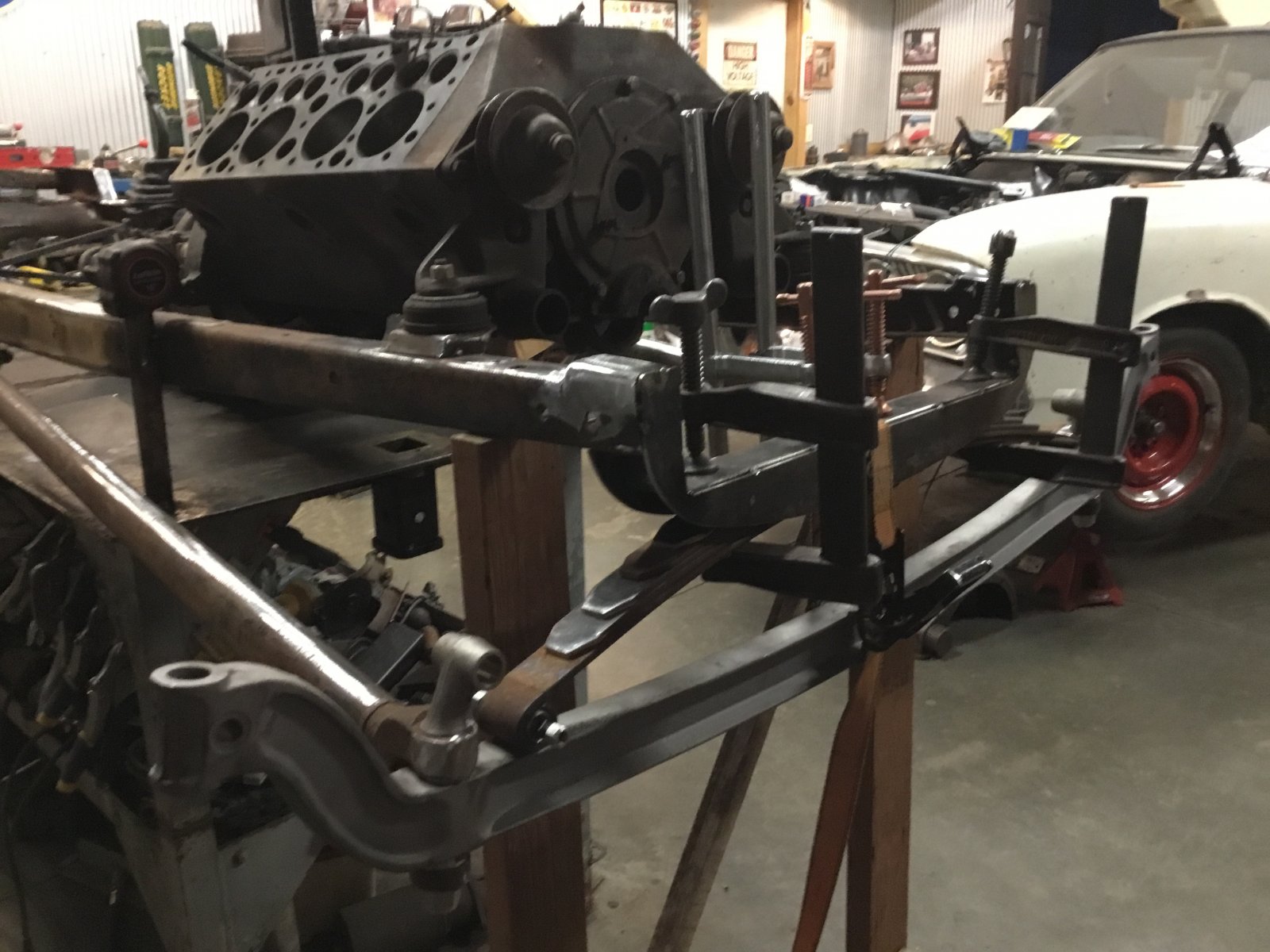

    Just had okie Joe do this one. It’s 2-1/2” 886863DA-65D1-4967-8198-08BA1C86F9CD.jpeg 169FA81C-DCAC-496A-AE52-BCAB1C88F7D0.jpeg

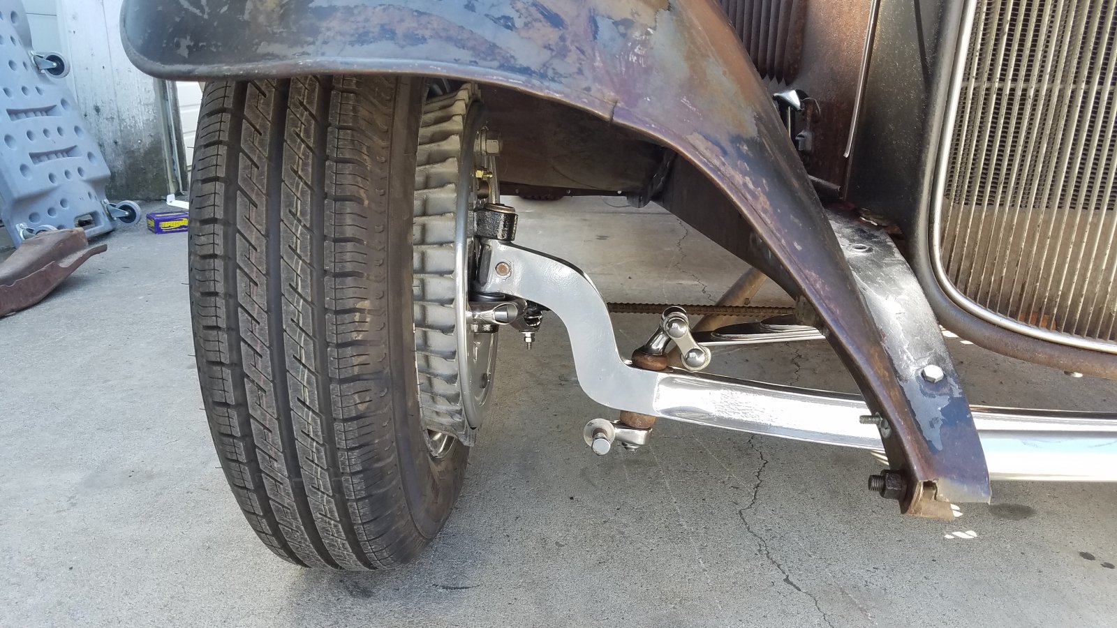

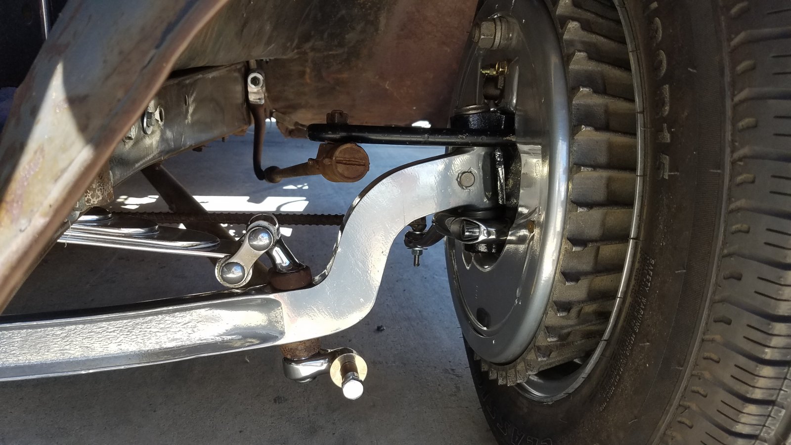

    Looks like 2 1/2 to me. This is a 4'' drop. Buy the way, nice axle. WIN_20210424_16_29_33_Pro.jpg

    This is the second 32 axle he has done for us first was 2” and this 2-1/2” both are super well done.
