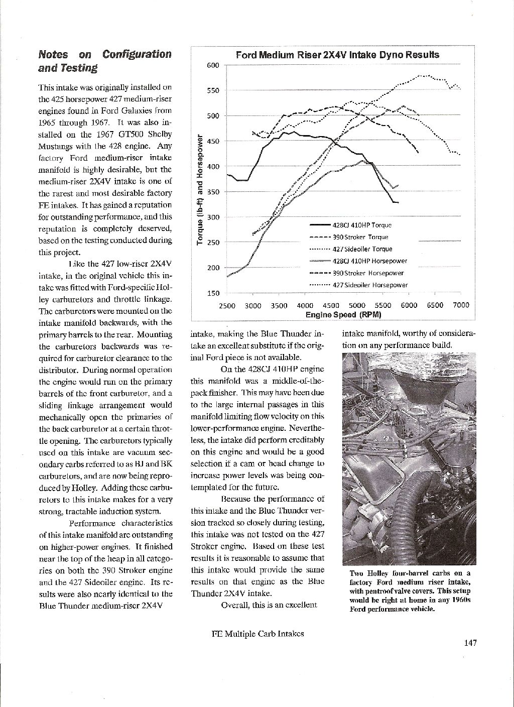

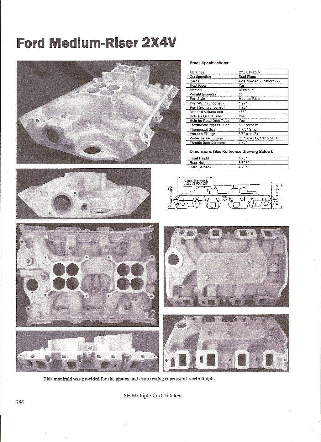

    For those that were-are wondering how much HP for an FE? I got in contact with Jay Brown on the Intake Comparo & asked his permission to post a couple of pages (he actually sent some). So Here is a sample of the book.
    Again these are a representation of what the book contains but is just a mere sample.
    Jay in great detail describes all of the nuances of ***embling a well ruunning FE as well as looking out for pitfalls (like oil leaks on the intake) and Cam, timing etc...
    The sample pages of the book he sent me are of the 427 sideoiler & the top manifold was about 605 HP. The bar graph shows the various manifold effects. Just from my understanding the FE 445 stroker would be about 100HP less but varies also from cam-heads,etc... Jay chose to block out the exact manifold names because you need to find out all of the differences to make a sensible conclusion (not a spontaneous decision on the value of a manifold). I totally agree with his thought.
    Hope this helps. Not an endor*****t of the book but I bought one with no regrets.
