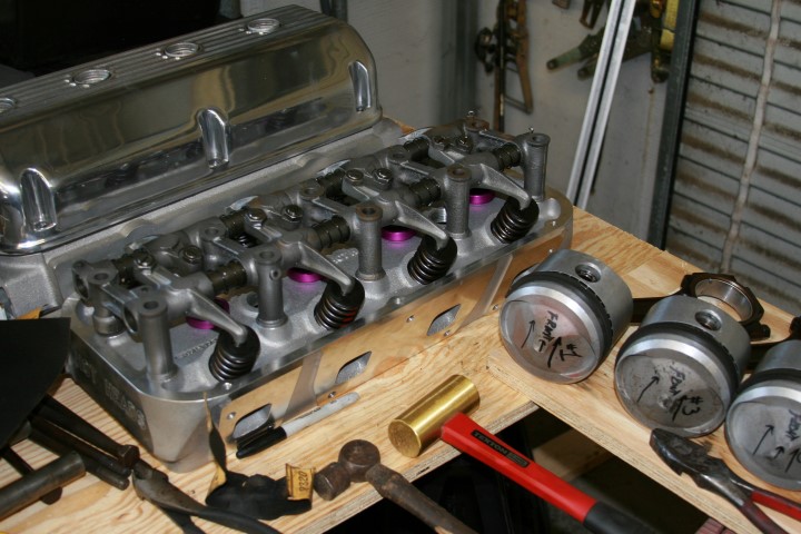

    I have a 392 Hemi that I bought to put into my chopped Model A over this winter. Its been a long story about this motor. It was supposed to be a built motor, on going to look at it that turned out to be not completely true. It turned out to be ( I think) a motor out of an old drag car. After I got it apart it did have a new solid lifter roller cam, a fresh and just turned crank ( .010/.010) new rod and main bearings yet it had the old cam bearings in it. It also had a brand new set of Jahns 12 to 1 pistons, that were unmarked as to size, so I ***umed they were standard. I went about putting it back together . At that point I miked one of the pistons and it turned out to be 4.120, yea that's right .120 over.
    So I hauled it to the machine shop and sure enough it has in fact been bored to .120 over. I tried my best to find a shop with a sonic tester with no luck. So I bought one myself, great little gadget to mess around with too by the way. I have measured every piece of metal in the shop. But to the block. I have now sonic tested this thing and know how thick it is, but I do not know how thick it needs to be, or what is considered safe. So my question is does anyone have a clue how much metal you need in those cylinders?

    Dave, Thanks for the bump I am a little surprised that there hasn't been some opinions or advice on this subject. Seems like on most threads like this the motor Guru's come out of the woodwork to voice there opinions. Maybe nobody knows what is or is not on this subject.

    Guys thank you all for your comments and advice. George I plan to ask you a lot of questions from time to time, thank you for your interest and advice.
    TR, The transducer that came with this sonic tester does have a very small amount of radius to it. I tried to slide a feeler gauge between it and the cylinder wall the smallest gauge I had was .0025 and it would not go so that is just going to have to be good enough.
    I did take multiple reading in each cylinder many more than 16. The two thickest cylinders were #2 and #7 which on the trust side had .210. The two thinnest were #3 and #5 which were at .198
    I guess taking into consideration the advice here and with these readings I am good to go. Thanks Again Guys!

    Jack, Man those are some damn good questions. You know I actually made a mistake with the part of that post with the .060 end gap. I have two 392 engines, one is the .120 over motor and another one that came along and I bought it just to have and because I found out that this .120 motor was that big. And I even confuse my self sometimes with which motor got what done to it.
    Now with that said the .120 motor came with a new set of Jahns pistons and rings already on those pistons. I just went out into the shop and pulled a ring off one of those Jahns and checked the end gap. It is .016. No I never did run the motor as it was when I got it.
    As to if it was to thin, well in that case I don't know what I would do with it. I have some money tied up in it as it sets. I could not sell it to some one without disclosing exactly what is going on with the motor and in that case I would have to ask myself the question. Is it worth what I paid for it? in all honesty I would have to say NO it is not, so the chance of me getting my money back out of it and maintain my honesty is just not going to happen. I guess I could get it back together and just dress it up some and LOOK at the damn thing. After all a lot of people spend tons of money on stuff that is just for looking at.
    I have spent a lot of money for parts for this 392, maybe I should say for "a" 392, yea that sounds much better. I have purchased a set of Hot Heads aluminum heads, and all of the other stuff to build this into a good street motor for my little Model A. This .120 motor came built in that it does have that set of new pistons, a new roller cam, a fresh .010/.010 crank, fresh valve job on the iron heads. My plan as of right now is just to put it back together as is--iron Heads, cam etc just like I received it. I am going to run this motor at least on my test stand just to see what it does. After that I guess I will just look at it... IMG_2847 (Small).JPG

    George, I have managed to completely screw this up. The problem is in the fact that there are two separate 392 engines. The first engine I got is the engine that is bored .120 Over and has the new Jahns pistons and rings. This motor I bought as a rebuilt engine so it was all together. It had been setting in the guy I bought it from shop for several years, so I was going to pull it apart and put it back together using the new heads and the aluminum parts like timing cover and chevy water pump new gaskets etc.
    The other 392 I bought when I discovered that the first motor was .120 over. I really didn't think with that much over-bore that it would be suitable as a street motor. I mean the Jahns pistons are 12 to 1 compression ratio and that along with the .120 over-bore I thought that motor was done. I then realized that I had a ton of money into this Hemi deal the .120 motor I paid $3,000 for add to that the $8,500 bill I paid from Hot Heads.
    Now I realize I can and will use the Hot Heads parts on the new engine so that is not a total loss. I still have a $3,000 piece of cast iron setting on an engine stand in my shop.
    The second engine I bought and had shipped to me from New Jersey. when that one got here I knew it needed to be built. Once I got it apart it had a set of factory pistons that were marked as STD. as were the main and rod bearings. There was no ridge at the top of that block so I thought and hoped that I could just re-ring it, install new bearings put on my aluminum stuff and be done. I desided to check the end gap of the piston rings just to get an idea of were I was at. That end gap on those rings was big I mean like .060. I then took this block to the machine shop and had them mike it. The machinest said man somebody has honed the hell out of this block. The bores did look brand new and had a nice cross hatch pattern. Turns out the block was .017 big. So I had that block bored and it cleaned up at .040 over. I bought a new set of .040 pistons and rings.
    What I think happened is someone started to build that second engine on the cheap. It probably (?) had a ridge at the top of the cylinders and they honed that ridge out of the block leaving it with the .017 over size. Once they did that they must have seen that the pistons were just to small with there .017 clearance, didn't want to spend any more money and sold the damn thing to a stupid SOB in Alabama.
    That still leaves me with the first motor I bought the .120 over engine. I would just hate to not be able to use that motor in something and see it go to waste. I cannot sell it ethically like it is, and just p*** the problem on to some unsuspecting guy. I will not do that so I am hoping beyond hope that it is not beyond using. That is the reason for this post. As long as there is a chance that it will work like it is I am willing to spend the money and finish the build.

  25. If it was mine, I'd try to figure out if my sonic tester was accurate or not. If it IS accurate, then your .200 or so wall thickness should be just fine - even if you were running a blower and mild boost. Personally, I find it a bit doubtful that the walls are that thick with a .120 bore . . . but that is just my perspective.
    I'm not a big fan of the old Jahn's pistons - they are probably the cast ones that were used back in the day. With a compression of 12 to 1, you'd need to run premium gas and make sure that you're not detonating it.

    I have tried to insure it is accurate, it is a mechanical device and thus I am sure there is some percentage of error. I have checked it against many, many pieces of known thickness material ( that is material that I can get to both sides to measure) and it is damn close. Notice I say close not perfect but close, very close. Remember that as a friend on here reminded me .120 over bore is actually .060 per side of the cylinder.
    The Jahns are the old school pistons from back in the day. They are cast as all Jahns pistons were. I spoke with the folks at JE Pistons ( they purchased Jahns long ago) and they are the ones that informed me that the #1108 Jahns piston were 12 to 1 compression. The fact I will need to run premium gas doesn't bother me at all, I mean I don't even have a car to put this Hemi in right now as I am going to build the other motor I have for my Model A.

    Well boys there you have it. You need .160 - .180 minimum thickness and he has .198 on the thinnest cylinders. The thicker ones are only .012 thicker which to me indicates pretty precise casting.
    Considering that the motor will not be supercharged, and will be loafing in a light model A driven on the street it should last forever.
    Can you double up on the head gaskets for lower compression?

    I think you can order Cometic gaskets in different thicknesses - which brings up the next point - .120 over gaskets may not be off the shelf either. Clark Gaskets can make whatever you need I'm sure. If you go copper like that, you don't want to run much radiator pressure though.
    The Hot Heads combustion chambers on my heads came out to 111cc which if bigger than most iron heads at 106cc so you might not be too high on the compression. I'd run the piss out of it if it was me :rolleyes:
