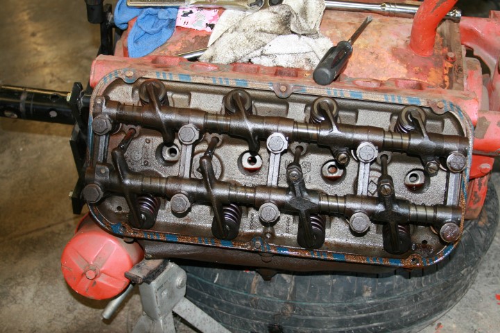

    I am a lucky guy in the fact that I have 5 Hemi's. Now don't ask me how I acquired all of the damn things It was just after I bought that first one they just started showing up. I did find a little history on that .120 over motor that inquired about in this post. It was in fact a drag motor, guy ran it in a G***er corvette of all things. It was injected then and a interesting question was answered by the Old Builder when I found him. There were a couple of things, funny things, when I got this motor apart. One was it does have a solid lifter roller cam, and adjustable Push Rods that is adjustable push rods on 12 of the liters. The other 4 had Adjustable Rockers, "picture above". The old guy I found that was on the pit crew for this g***er and built the motor all those years ago had an explanation for that. He said thy were at a Drag Meet in Texas and during a run tore up four lifters and bent the Push Rods. According to him there was another car there a Willys that had been eliminated and this guy furnished the adjustable rockers and the push rods from his motor so that they could continue. When the meet was over they guy that loaned them the parts had left and they never were able to return them to him. Cool what you find out sometimes.
