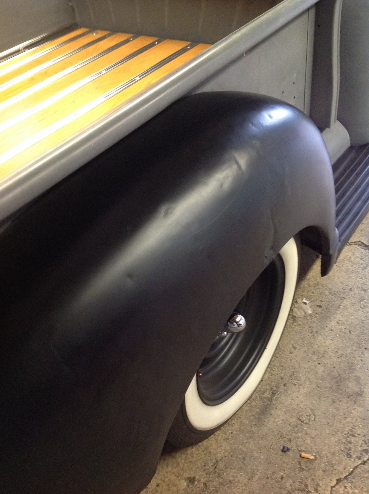

    Couple guys wanted pics. There is a few of the truck in general and a couple so you can see the bodywork that needs attention. Thanks again. Everyone on here seems like a good bunch of guys. I was on forums for another vehicle I own and everyone there was tougher than the next guy.

    I don't understand some of these comments. There is no such this as too nice of a paint job.
    One of our customers who competed for the AMBR, just hopped in his car and took a road trip.
    These are cars, they are meant to be driven, even when they are finished very nicely.
    Of course not every car has to be taken to that level.
    Here is my opinion on your truck. You don't have just some truck, or a beater. You have a custom truck, which to me means that you do need to look at some details, think about gaps, get panels straight, and spray shiny paint.
    Looking at your photos, there is definitely some straightening to do. The areas where metal work has been done is obvious. It's not the best metalwork, but it's far from the worst. Certainly good enough to make a real nice truck.
    A good paint job is all about the prep, which is time consuming, which means expensive. But, the good news is if you're willing to take the time, you can learn to do it yourself. That is what I would do if I was you.
    I do agree that since you just bought it, you should take a season to drive it, and work out any bugs and/or make any changes you want. Then give it the attention to detail and finish it deserves. You have what could be a real cool custom truck, don't short change it. But all that is just one mans opinion.
    I'm doing the same thing. I can't afford the paint needed for my projects, so I'll take the time to do it myself. In fact thats the same way I got into building cars. I couldn't afford it, so I learned it.
    If you are willing to learn and put in the work, no level of car is unobtainable.

    It is sure a lot nicer than what I started with.. Looks like the panels were welded in an the welds were ground down.. I had rather see that any day than a mess of mud an screen wire an PBR boxes holding my cab corners on.. Do one panel at a time by the time you finish the truck you will know a lot more about body work!

    It looks like the work so far was pretty well done. At least they didn't booger-weld it together and pour gallons of bondo on it. You can take it to any level of finish your heart desires-- limited only by the budget.
    Unless you have money to burn and you don't care, it will be easy to exceed the truck's value if you shoot for a high-end finish, especially if you're sending it out to a shop.
    I'd take it panel by panel and leave the color scheme as-is.

    The only thing I would change is the location of the upper mount of the front bags. It looks like the spindle, or the nut might be able to contact the bag.
    You NEVER want metal touching the rubber of the bag. If they can rub, you could be in for a nasty surprise.
    I'd fudge them inboard slightly.

    I agree with moving the mounts inward. Is it ok to have them angled and not straight up and down.
  26. gimpyshotrods
    Joined: May 20, 2009
    Posts: 24,630
    gimpyshotrods
    Yes, most bags can handle being operated off-axis, within reason.
    This would be well within reason. I doubt you'll need to move them much.
