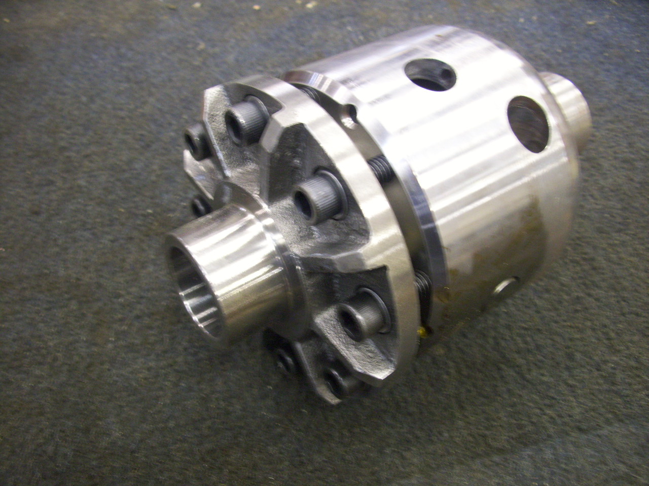

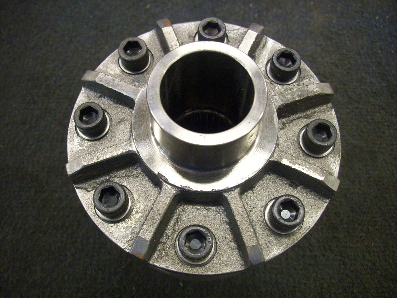

    @JimSibley,
    This might help you.

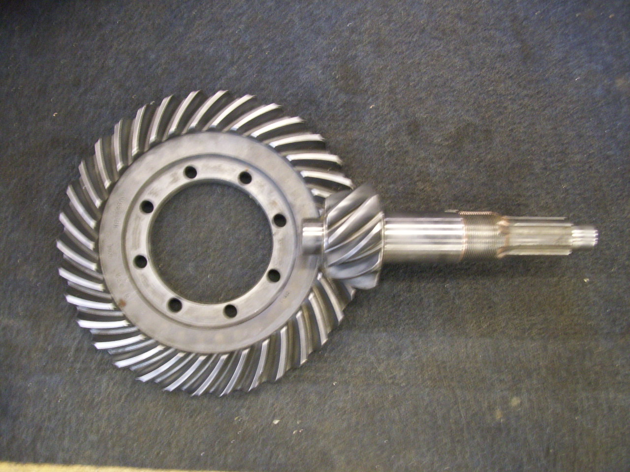

    31 spline Halibrand 2 spider open differential. I bought several of these from Halibrand in Kansas before they closed up.
    You have to modify the ring gear like in the last picture but it takes the axles out of the equation. I might have one left. Message me if you're interested.
    Bruce

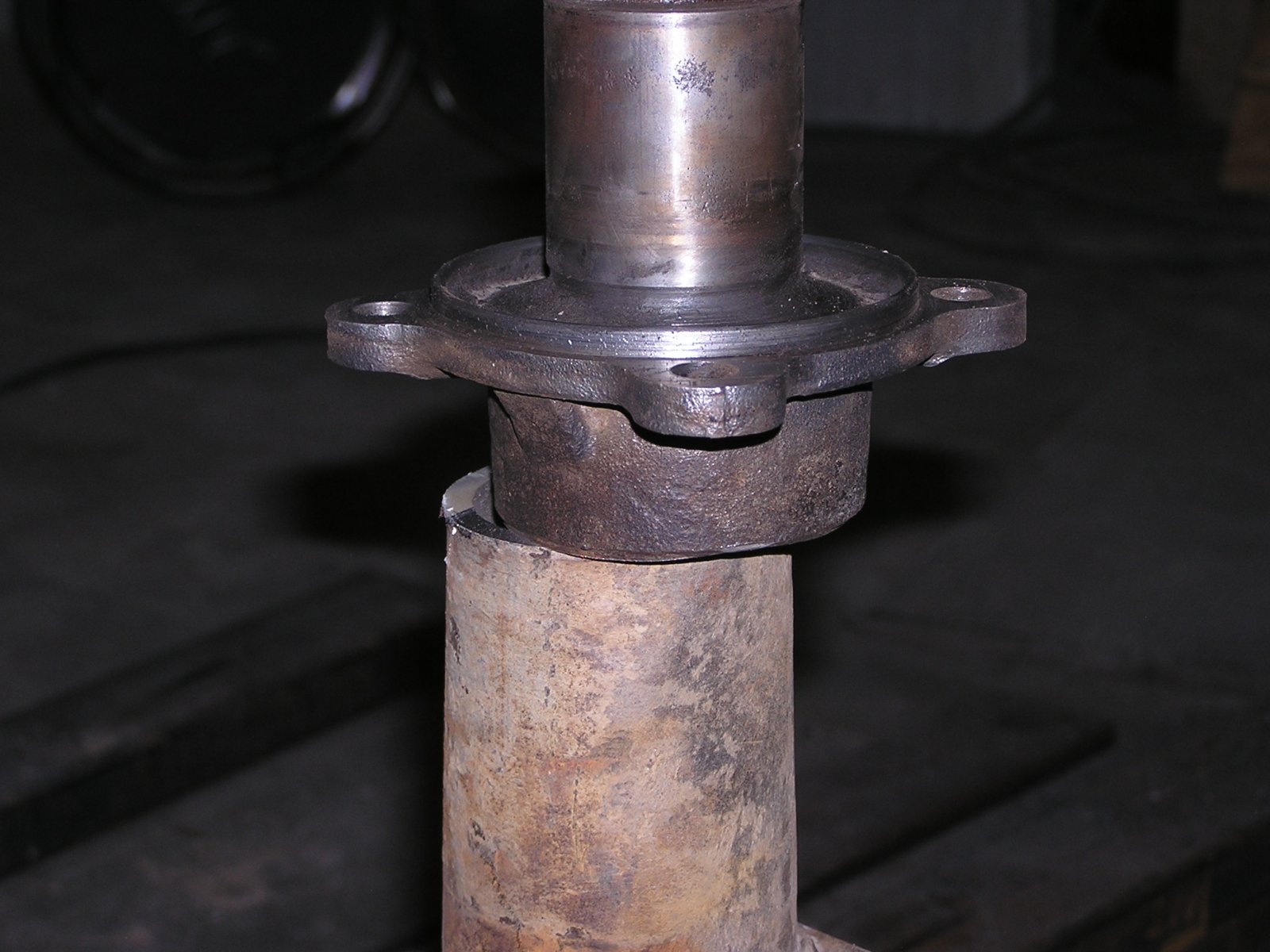

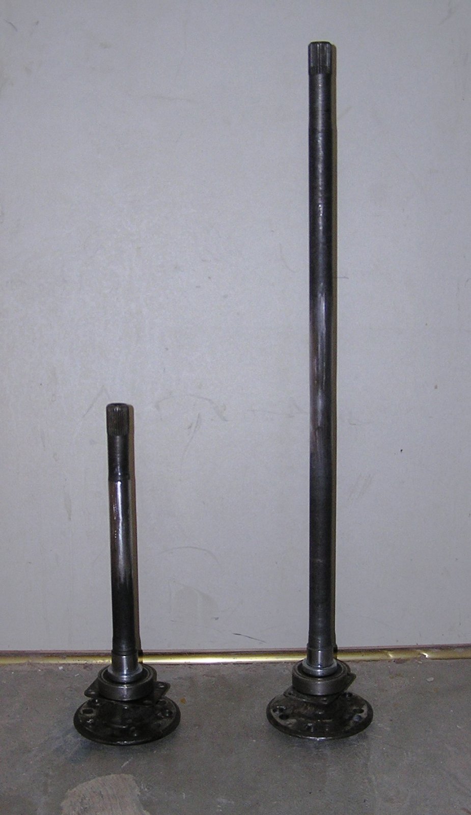

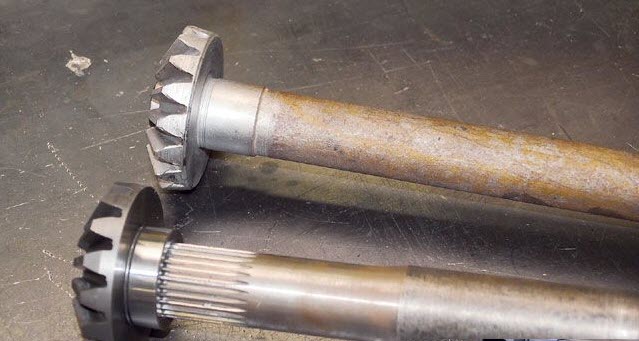

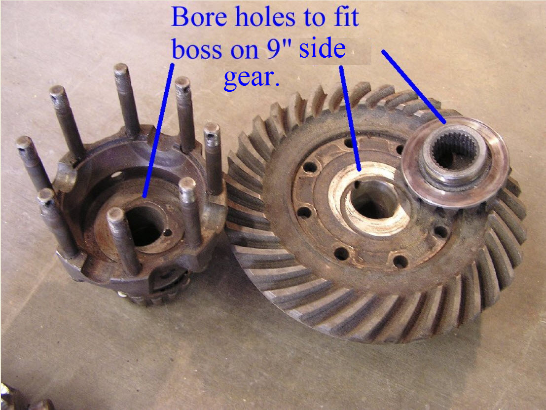

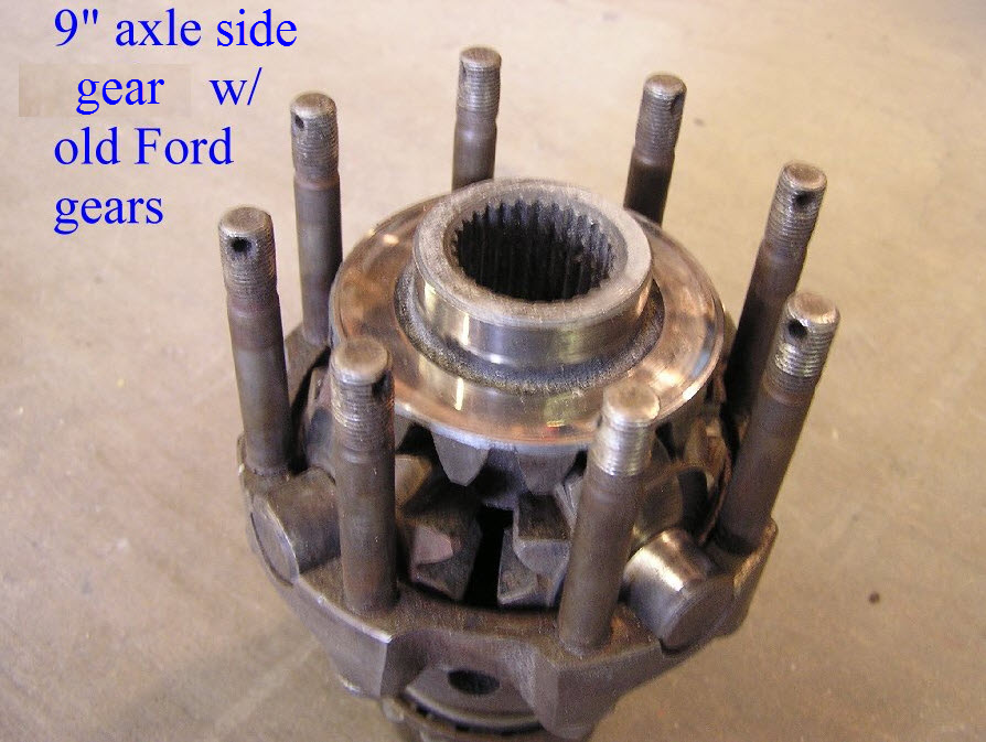

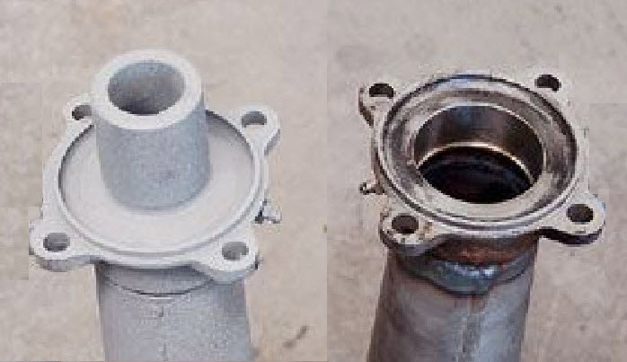

    Best friend in HS and best man in my wedding had a '40 Ford pickup with a 289, 4spd, and banjo. He got a set of real 12" wide Indy tires he ran on the rear. Combine that with a heavy foot (lost his license for a few months due to too many moving violations!), and the result was spending almost every weekend replacing broken axles.
    I put 9" axles in the 2 banjos I put in my Mysterion reproduction. Overkill but made adapting the proper wheels easier.

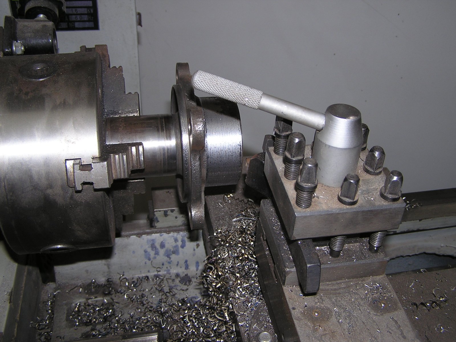

    on the outer end of the axle tube I cut off the snout. Then since I shortened the tubes, I cut the ends off and bored them to accept the seal. Finally I used the aluminum bearing retainer shown in a post above.

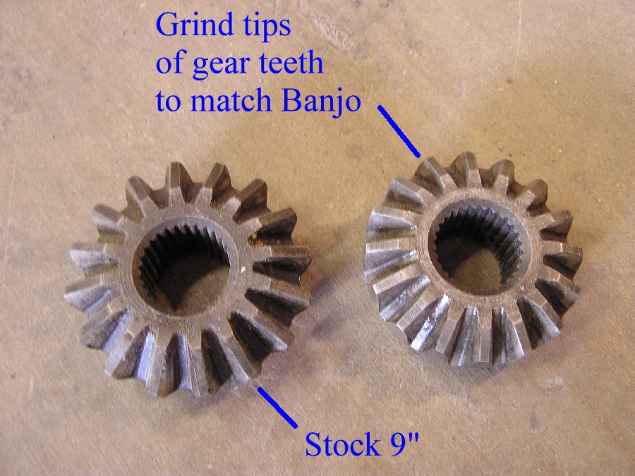

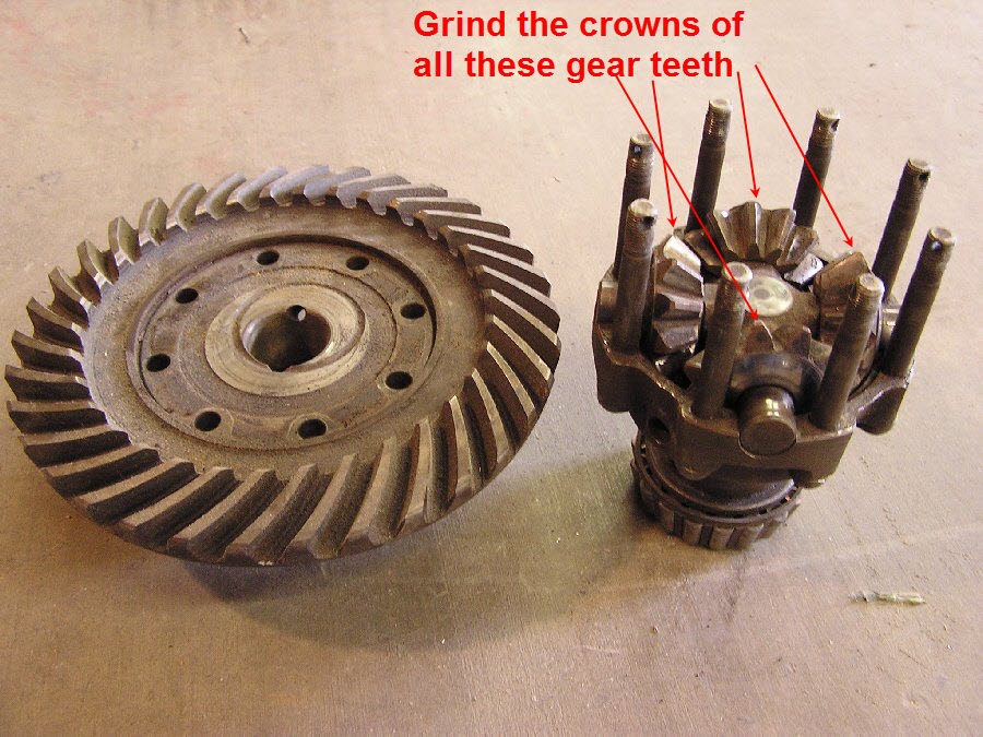

    On the ring gear end, there are a few modifications required to adapt the 9" axles. First, I used 9" side gears with banjo spider gears in the differential. The tips of the 9" side gear teeth need to be ground down as do the crowns of the banjo spider gear teeth. A purist would do these mods on a lathe but grinder does a fine job.

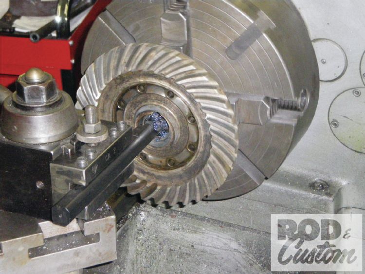

    The other mod is to bore the hole in side housing of the differential and the ring gear to accept the larger diameter of the 9" spider gear bosses.
    These mods allow the differential to ***emble and accept the splined 9" Ford axles.
    boring ring gear.jpg on left is cup wiht bore.jpg old & new gears.jpg Ring & Spider.jpg Spider comparison.jpg Spider in place.jpg
    I shortened my 9" axles by cutting and welding. I believe this is still stronger than stock banjo axles but if you can't go with welded axles, you can have Moser or someone make you set of custom axles.

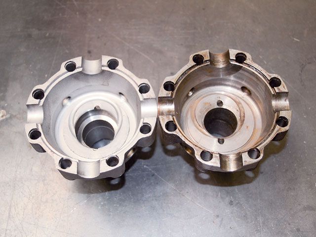

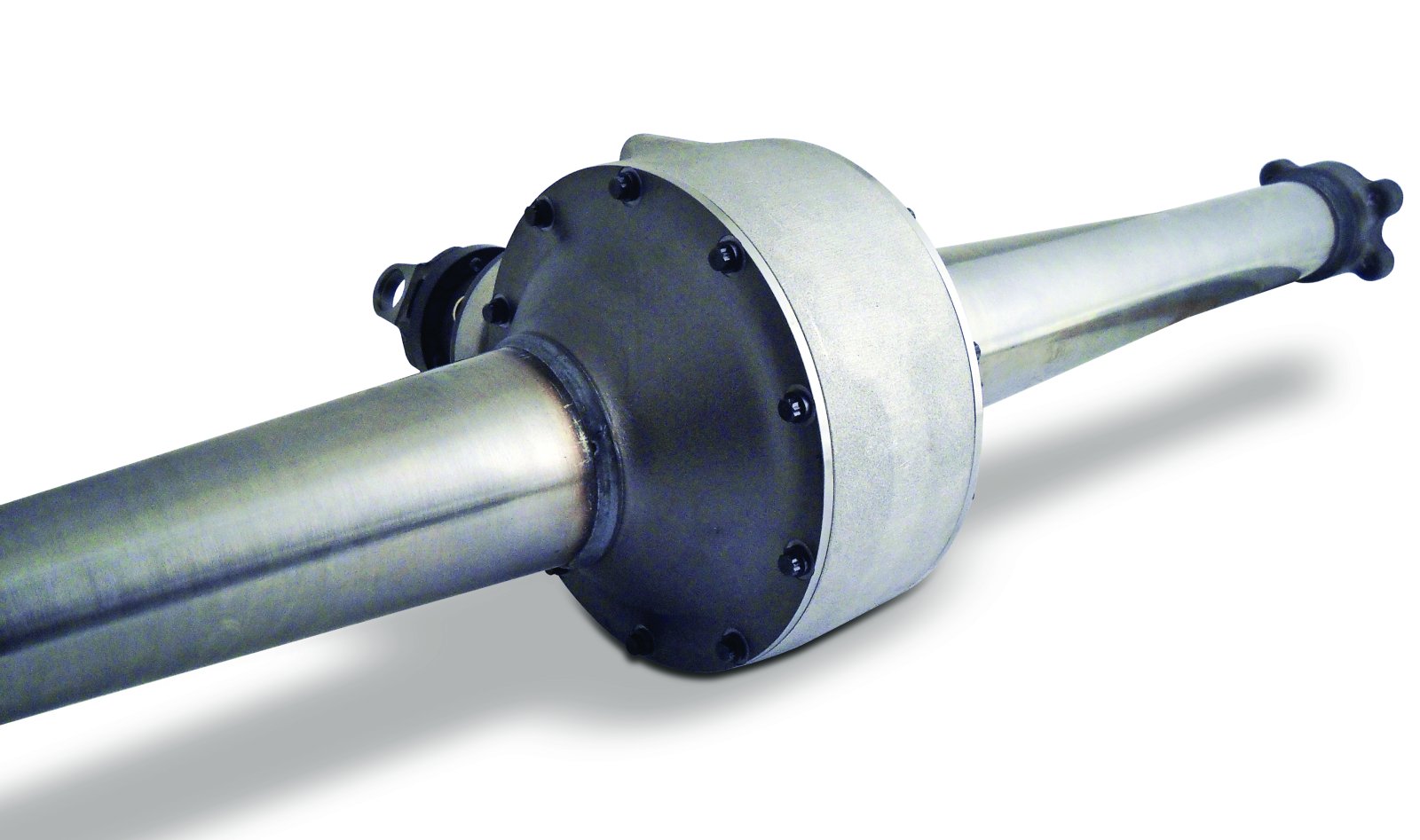

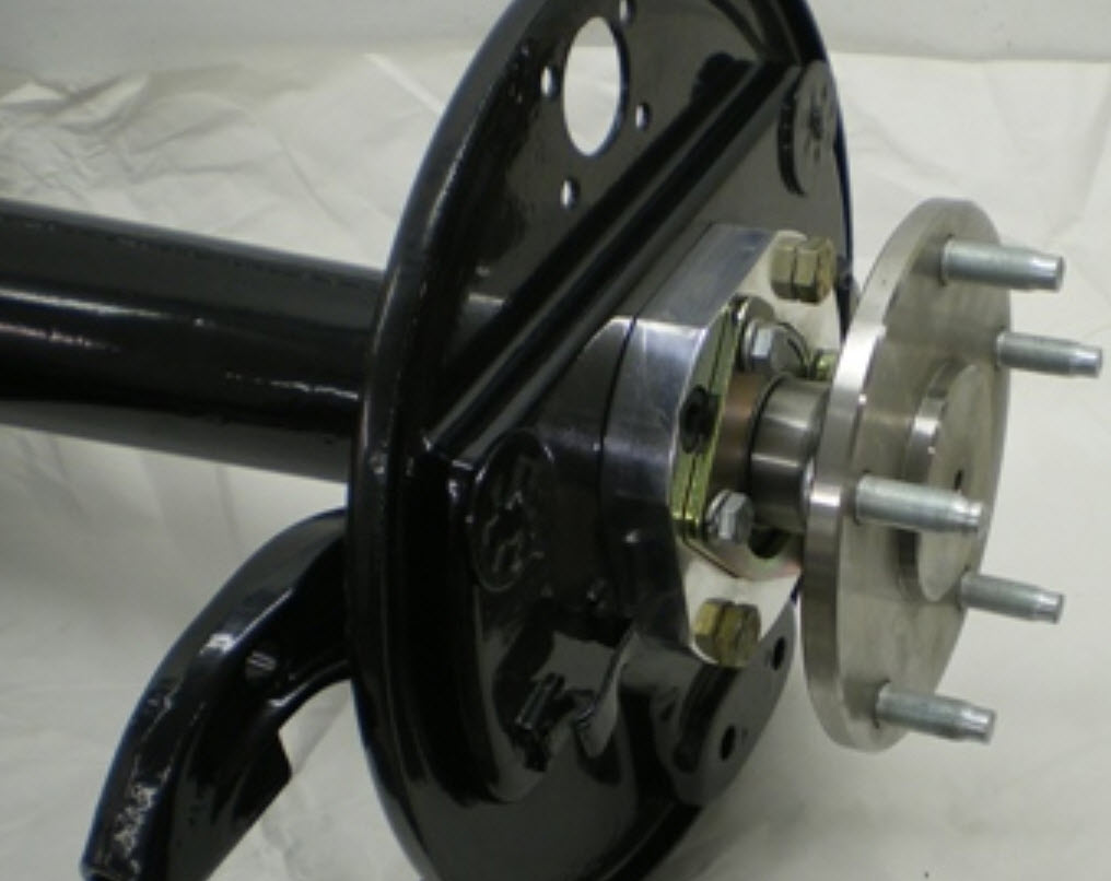

  25. I don't want to turn this into a sales pitch, so if posting this here isn't cool I can delete.
    But in case it's helpful, we make a banjo rear that's good for about 600hp. It uses our tapered steel tubes and bells, which aren't identical to early Ford (they taper to about midway out the axle then go to a straight tube, as you can see in the photo), but they're close. Otherwise they use all new internals (3.78 ratio R&P, wedgelock differential, modern axles) so you can keep the early Ford vibe but they'll hang in there under load. ST&B Banjo drop shadow FRONT.jpg
    Lucky Eddie, Squablow, trad27 and 4 others like this.

    I too have done that with the trumpets. Not too bad on a lathe without the spring perches. I also did it on a mill leaving the perches on. That is a lot of boring but can be done.
    Have a customer that wants to do that, but the tubes will be shortened. Only problem there is that my lathe won't swing that much with the perches in place. Oh well, back to the mill! :(

    Yep. My saving grace(s) were no perches with Big Daddy's coil spring suspension and, had to shorten both tubes so could cut off the bearing bosses which easily fit in my Chinese 12x36 Acra lathe.
