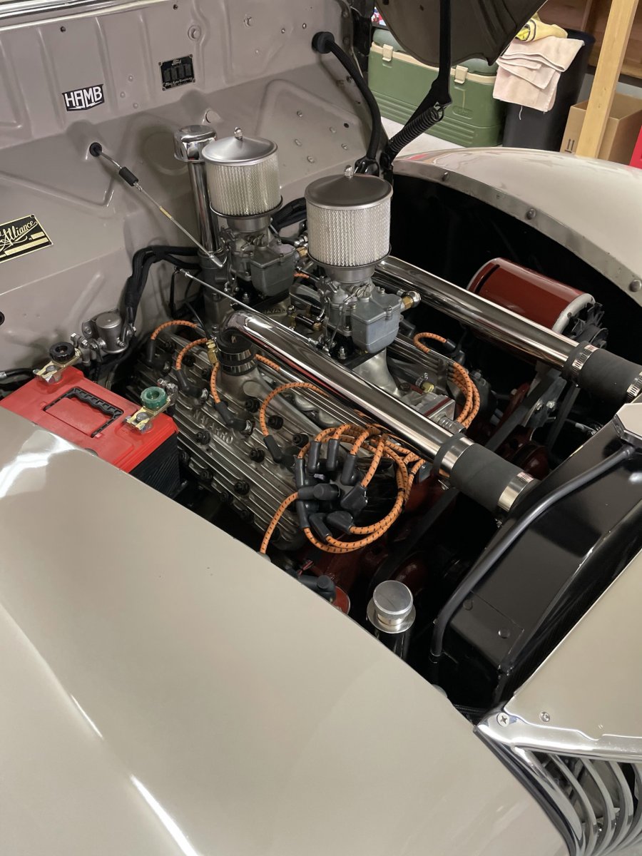

  28. Norris McCarty
    Joined: Apr 19, 2007
    Posts: 346
    Norris McCarty
    I’m running 25 all in at 2200 on my 40 coupe with a 53 Merc with Chevy dizzy(best change I’ve ever made)
    Guess I need to lower it a couple of degrees, but all I have is a “****” dyno! I’d love to pickup 25hp!
    I imagine even my old **** could feel 25hp!
    GlassThamesDoug likes this.

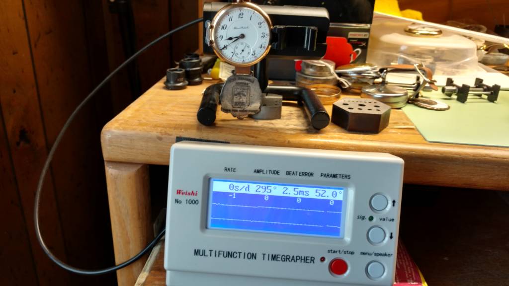

    Joined: Feb 19, 2013
    Posts: 4,201
    winduptoy
    I try to get it within a couple seconds a day and the amplitude between 270 and 300 degrees. This one from 1911 IMG_20210110_084040149_HDR.jpeg
    Sent from my XT1585 using The H.A.M.B. mobile app
