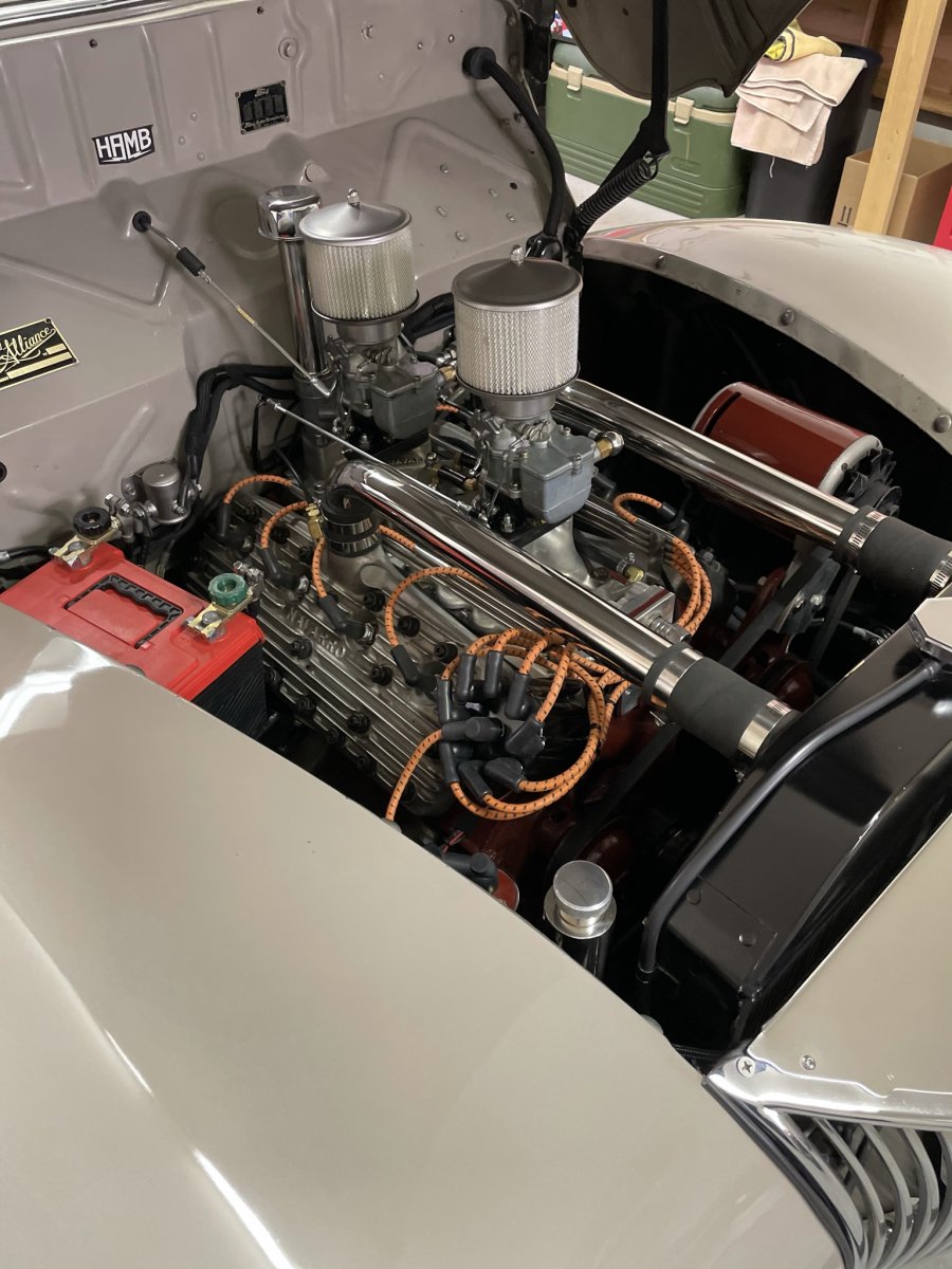

  4. Norris McCarty
    Joined: Apr 19, 2007
    Posts: 346
    Norris McCarty
    Thank you for the compliment.
    No, it wasn’t really a question but a statement.....as soon as the weather clears I’m going to drop my timing to 23 total advance and see if my **** dyno can feel a difference. I can’t imagining it being any stronger, but you never know. I went from 27 degrees to 25 last year and that may have been my “magic” drop. :)
    Flatheads don’t need/want timing as high as most V8s do.
