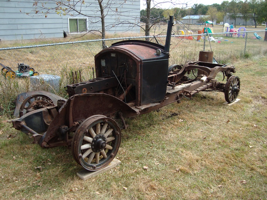

    Picked up a S10 8.5" rear axle to put in my '28 Buick project.
    Replacing enclosed drive shaft ***embly.
    Leafs spring mount at end of springs - not in middle like a modern truck.
    Thinking of building a plate that will bolt between housing and cover. Would like to run 4 bars to that plate. Can I get by with having my 4 bars that close together?

    Hard to imagine what you're describing but it sounds like 1/4 eliptic suspension would be a better solution than four bars.
    If you mean sandwiching a plate between the sheet metal rear diff cover and the housing to attach the upper bars then why not just weld the mounting point to the rear end housing where you need them?

    post pics of what you are working on

    Don't have access to a welder right now. That is why I am trying to do everything bolt on.

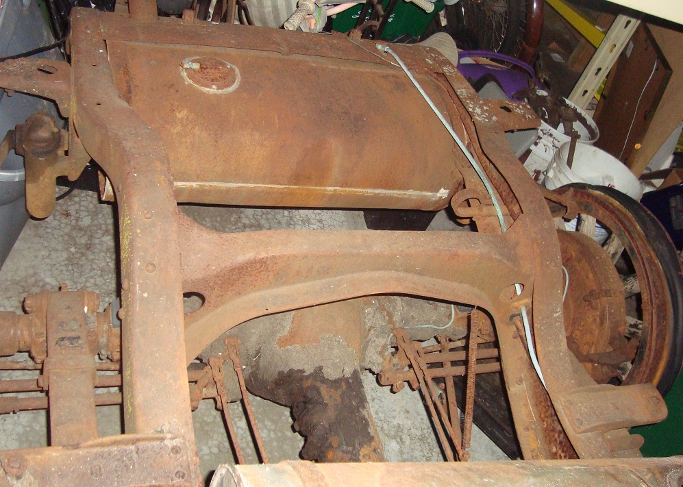

    No, you cannot have your 4-bars that close together. Nor can you use a 4-link with quarter-elliptic springs if they connect directly to the axle without a shackle.
    What you have shown in the pictures is a quarter-elliptic suspension. The springs locate the axle side-to-side, and the torque tube (rigid driveshaft) keeps the axle from wrapping up.
    You can keep the rear springs with an axle swap, but you will need something to recreate the function of the torque tube. That can be a torque arm.
    That can attach to the axle (as you cannot weld easily to cast iron) via a plate sandwiched under the differential cover.
    Still, there is little likelihood that you will be able to pull this off without a welder.

    barnbikes
    from MN
    I intend to use the existing leaf springs and mounts if I can. Have to measure axle housing diameter of old and new rear ends. The spring mounts move on the housing axle housing.

    There would be infinite axle wrap, right until the driveshaft got unplugged from the transmission.

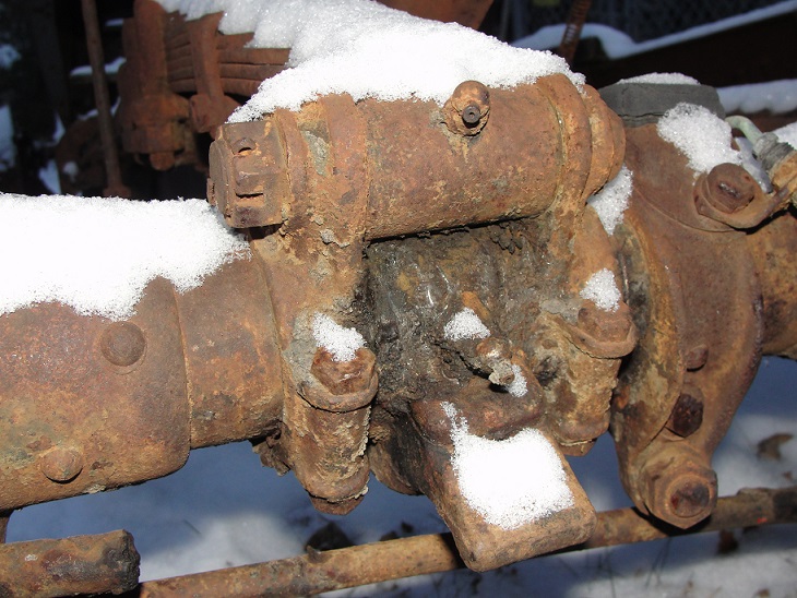

    The spring mount has no shackle. Large tab on back bottom os for the strap that goes to the shock absorber. Bracket next to spring mount is a rod that went to the enclosed drive shaft.

    That is a pic showing it is in a way shackle mounted..Notice the grease fittings..

    Not a shackle, just a pivot.
    Your easiest route here, should those axle clamps on the existing tube actually fit the new axle, is a torque arm. It just replicates the torque tube. Still would need someone to weld.

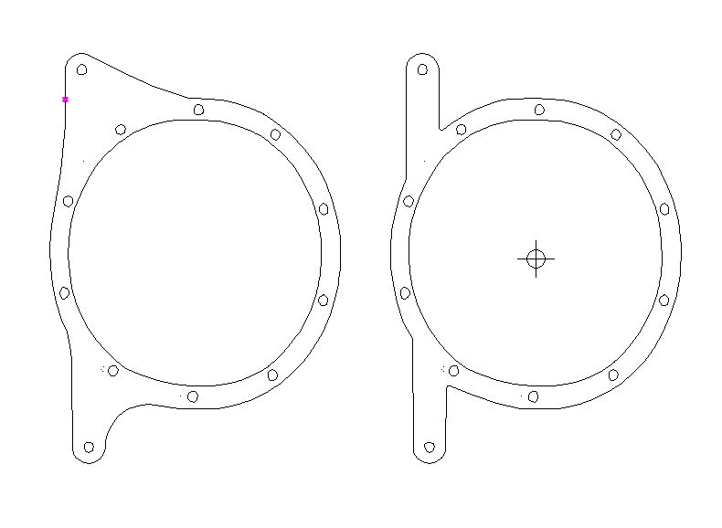

    Did a quick doodle.
    Probably 3/8" plate?

    If you can move the "ears" out to the edge of the oval, a straight rib can be welded on to it.
    Without that, even 3/8" will be bent, like a cheese slice.
    Also, fill in the valley between the ear, and oval, like the top of the left one. The more metal, the harder it is to bend.

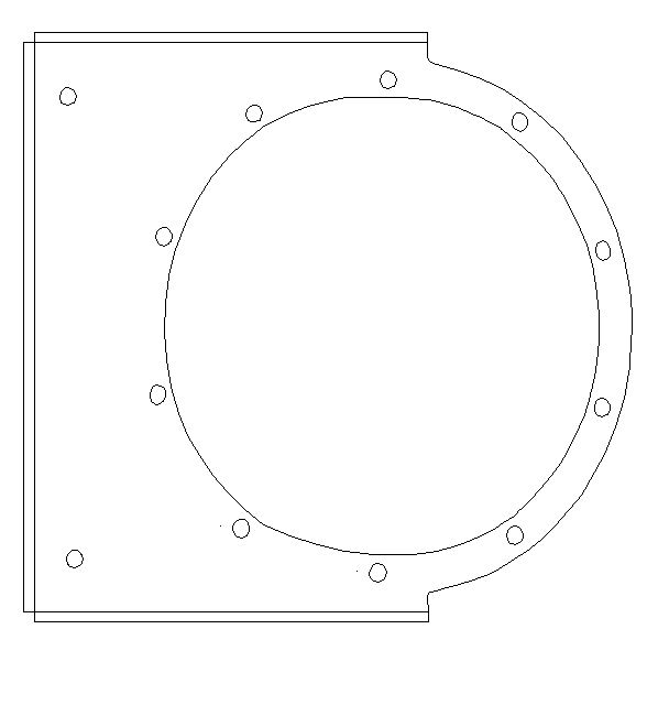

  25. barnbikes
    Joined: Oct 28, 2009
    Posts: 96
    barnbikes
    from MN
    Something more along this line then?
    For the torque arm would you suggest solid rod or thick wall tubing? 1" ok?
