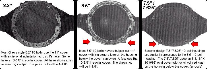

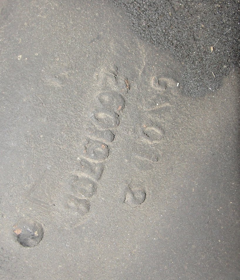

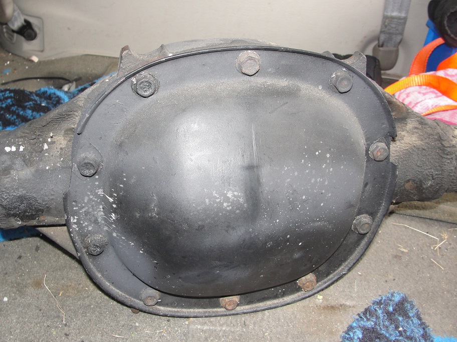

    Well apparently I was told wrong about my rear.
    Looks like a 7.5 rear end.
    Looked on the tube and found what looks like a UT9????

    gimpyshotrods
    That does appear to be a 7.5.

    gimpyshotrods
    Those have been known for a decent amount of low-end torque, more if you bolt on some speedy goodies.
    I would not put that 7.5 behind one.

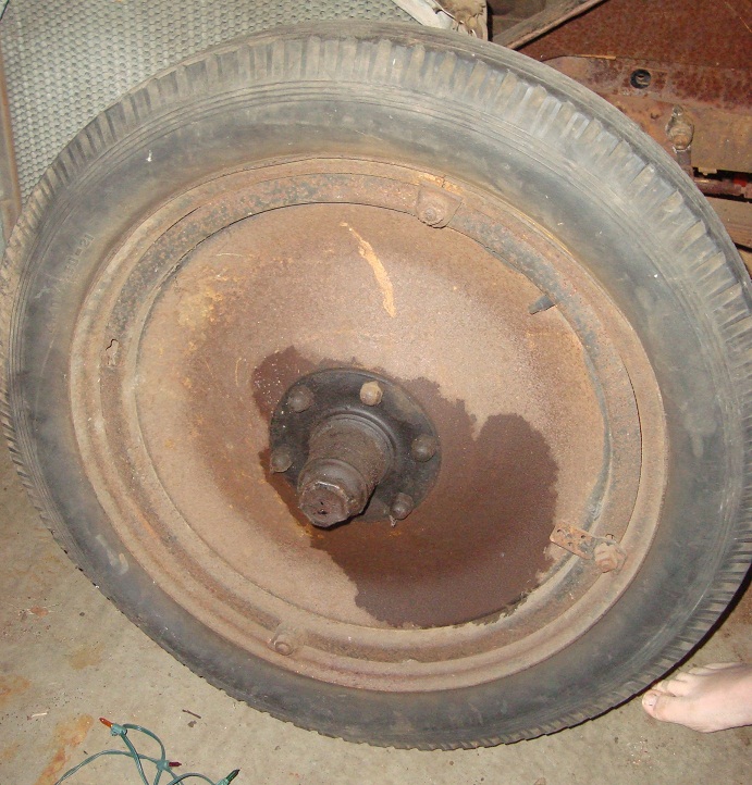

    from MN
    19" 1929 Chevy wheels.

    They are probably going to get redrilled or the axle will be.

    gimpyshotrods
    Safer to re-drill the axle.

    Hackerbilt
    Large diameter wheels and tires increasing strain on small axles.
    High torque six thru a standard trans.
    Gotta redrill the axles or buy adapters to make things work.
