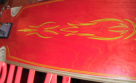

    Didn't lay out the flames, just giving them a long overdue striping. This was done last year I think?
